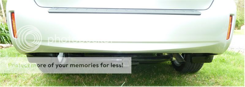

    Hi,
    Wife takes girls on Scouting trips etc and usually has a pile of light stuff like sleeping bags and cloths. Sometimes tossed firewood in back of van. Kids have their skates and bits for trips to Grandmas. The three guinea pigs may join us. Not heavy, it just takes up room. We needed a way round it if we were to downsize to V.
    Installed Curt Hitch in 40 minutes. It's light, I rested it on my chest as I moved it up and bolted it on. Only issue getting the exhaust baffle plate not to touch and maybe squeak. V Looks light strength under there so will not be pushing it with any heavy loads. Only light stuff will be hanging out in rack.
    Added 'Tow Ready 65855 36" x 20" ATV Cargo Carrier' with 1-1/4" shank. I know, going to get jokes about ATV label!
    When we were looking at 'V' I asked salesman if putting hitch on would effect warranty. 'No, but I will check'. Manager came over and agreed and we wrote that on contract I was signing. Any problems will be with dealership if Toyota ever complain.
    V will have its second run to grandmas this week (700 miles round trip). This time we will need carrier on back as guinea pigs and their cage are coming.

    Rack fits in back of V even with the shank attached.

    Looks great! Thanks for sharing. One question, can you open the hatch with the rack attached?

    Quentin,
    It would be easy just a pain to do. When you put original bracket back you wouldn't even know hitch had been on. There is enough clearance to not have to jack up vehicle to do job. I did mine on garage floor. I rested hitch on my chest when installing, its not heavy. I didn't remove the exhaust rubber hanger. Exhaust moved to side enough that I got straight to bolts with socket.
    Dave,
    If I slide the carrier back in hitch I can open hatch, BUT I only have 1/2 inch in hitch and it could drop out. If bar was 4 inches longer I would be fine. When I get back we are going to weld extra 6 inches or so to stalk that goes into hitch. 1 1/4 inch square bar so that I can undo pin and slide carrier back several inches and hatch will clear carrier. If we are not happy with weld we will make a new bar from carrier to hitch that is longer at hitch end. The carrier is not too heavy and I will only have light loads making it easy to slide back. If I look through hitch I have clear view to front of car, so bar going through hitch can be as long as I want. Too long will be a pain to store carrier though.
    Hope that helps guys.
