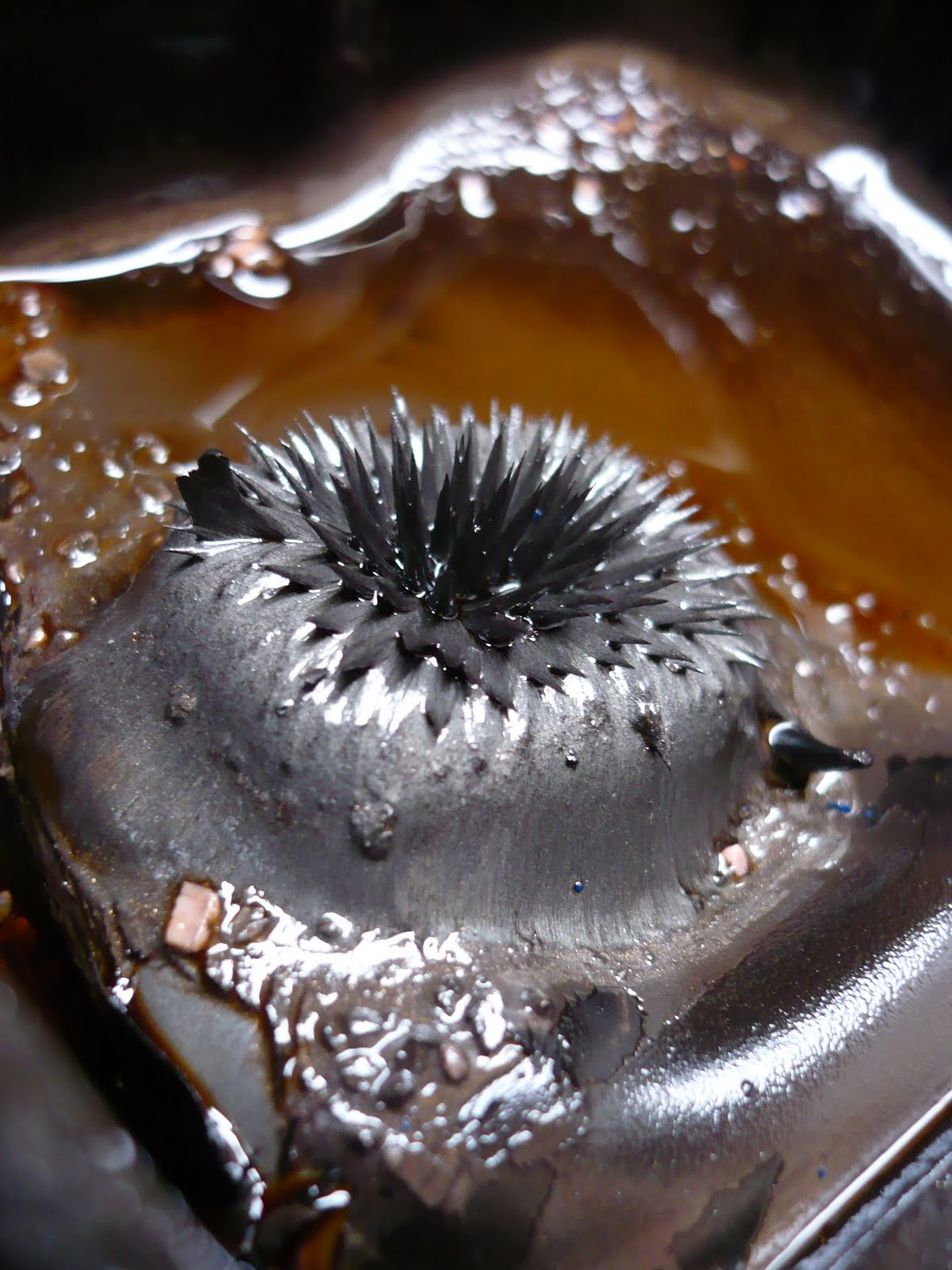

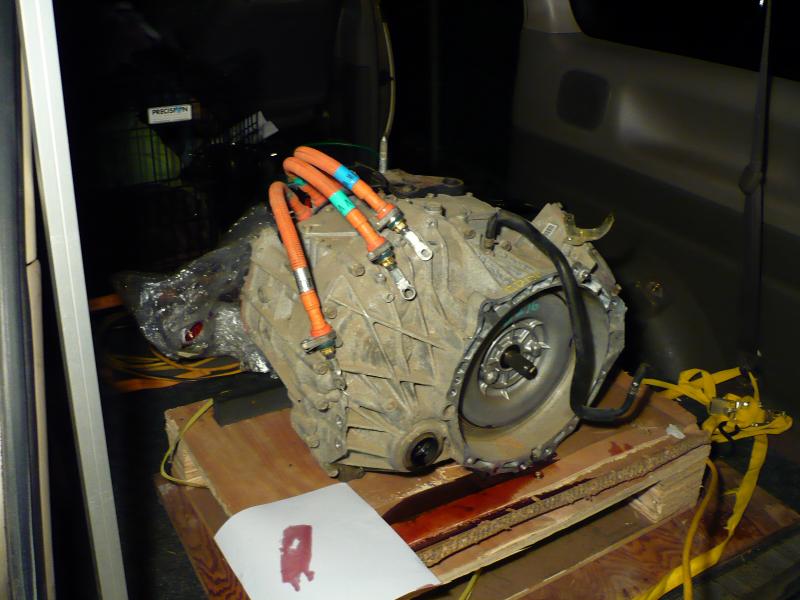

    Picked up the replacement transaxle from my friend's studio and it seems as advertised. The oil is bright red and clean and thick. There isn't a spot of a leak anywhere. The cables are quite clean with just a bit of dust on them. All the bolts have the original paint marks on them and have never been removed. There is some dirt on the top and it's a bit corroded, but it presumably has been sitting on a shelf at the wreckers for a few years. The input shaft spins smoothly.
    The only damage I could find was a cracked plastic connector and a few scratches on the inner surface of the output shaft bearing. Not a critical area. I can hopefully swap the cracked connector with one from the original unit.
    I have to get it into the shop now to clean it up, drain the rest of the oil, clean the pan, fill it with new oil, replace the shaft seals? (they seem almost new), and inspect it as best I can.
    Overall pic with a blot of the oil:

    Another shot of the oil and the good condition of the shaft seal:
    [IMG]

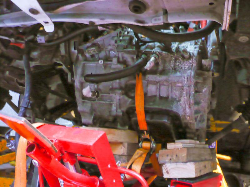

    Got the beast out. That is a tight fit.
    Tomfreed, do you gave any tips on getting it out more easily? The ICE motor had to be pried out of the way to make room. How I will get the new one in is a mystery. I may hoist it in from below with a chain hoist mounted above. The ability to swing and rock would be a big help in getting it in.
    Now that it's out I'm not getting the cogging. I can spin the CV joints which spins the input shaft. I think it means that the mg2 is ceased because the cogging was the ICE being rotated by the wheels. I imagine if it was not ceased it would rotate freely so the Ice would be unmoved by wheel rotation in neutral. . Just a guess. Would also explain the lurch when I tried to start the car. It would immediately stop and flash all the warning lights.

    It sounds like the power split device (PSD), the planetary gear is jammed up tight. You may have a good MG1 and MG2 stators (ok, heat stressed but usable) and the PSD has a chunk of something making it into a single part. Alternatively, one or more spider gears may have seized on their shaft. That would do it too.
    If you ever wanted to make a pure EV Prius, take the transaxle apart and weld-up the PSD. Then put in motor controllers for MG1 and MG2. Their cumulative power:

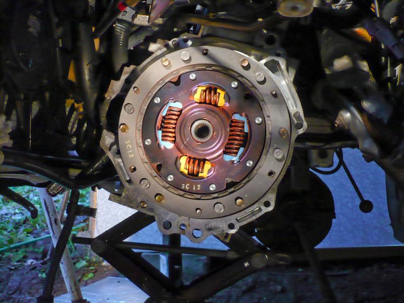

    Got the replacement transaxle out of the van and hoisted up to take off and clean the sump. The newer sump is just dusted lightly with filings and the magnet is a little bump compared with the huge pile on the old one.
    Compare and contrast:
