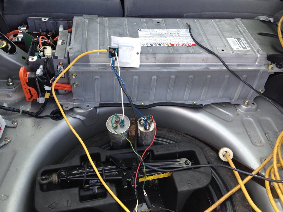

    Here is a homemade grid charger that one of my customers made.

    ...without understanding much about what I am looking at, but, alligator clips?
