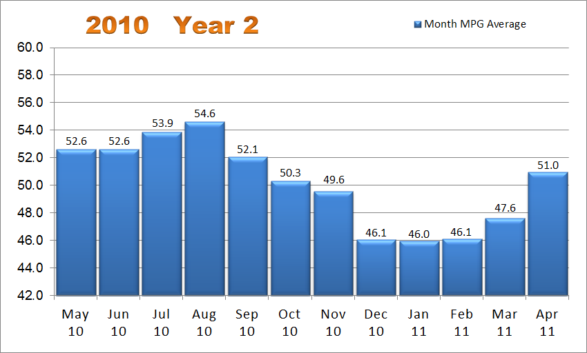

    This graph show my seasonal variation over two years, without any tire change, in a milder winter climate than MN, and with fairly light use of winter heat:
