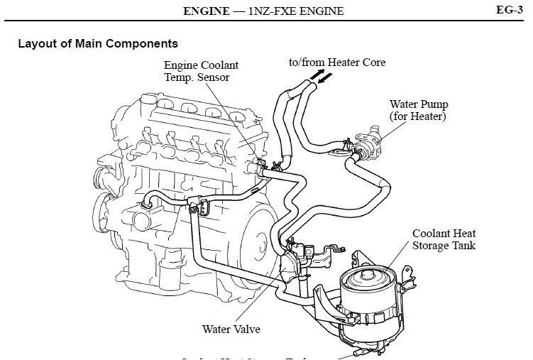

    On that second video, is the car moving or just sitting there?
    I do hear the sound I think you mean in this one. I'm going to go with one of the small electric motors under the hood, and probably one of the pumps. What clinches it for me is the sound toward the very end when it stops, a very characteristic pump-winding-down sound.
    If not a pump, it could be one of the radiator fans, which also start and stop like that, but I'm still leaning toward pump.
    I don't know what your HVAC settings were at the time of that recording. A Gen 2 has a number of pumps under the hood, and one of them has the job of pushing water to the heater when the engine is stopped (because the engine's own water pump in a Gen 2 depends on a belt). I've heard that pump cycle on and off like that in other Gen 2s (though usually more quietly ;)) when there's just a slight heating demand. The one I mean is the one shown here:
    Do you happen to have a mechanic's stethoscope? They're really cheap at an auto parts shoppe, and they can make really short work of questions like this.
