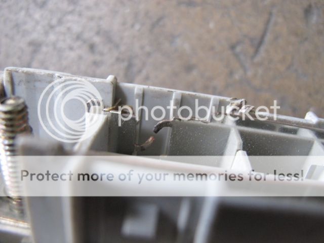

    Did you check the big fusible link under the hood of the car? (in the box where you jump start from the front) They are under a clear cover.

    1. Did you check the tightness of the negative battery cable where it bolts to the body?
    2. When you get your digital multimeter, use it to measure voltage at the 12V battery positive post, to body ground. Find an unpainted bolt on the sheet metal to use as your ground connection. If you have a problem here, then obviously a connection is loose or else the negative battery cable is broken or has an intermittent connection.
    3. Assuming 2 is good, then measure after the 120A fuse, to ground. If you measure voltage then the fuse is OK.
    4. Assuming 2 and 3 are good, then measure voltage from the positive jump start terminal in the main relay/fuse box, to ground. If you don't measure voltage here then there is something wrong with the positive battery cable leading from the battery in the hatch area to the main relay/fuse box.
    5. If 2, 3 and 4 are good, then look at the fusible link box located within the main relay/fuse box for burnt links, as suggested and pictured immediately above.
