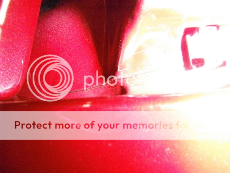

    2006 Prius crack right rear corner
    *Goldfinger* and GasSippr like this.

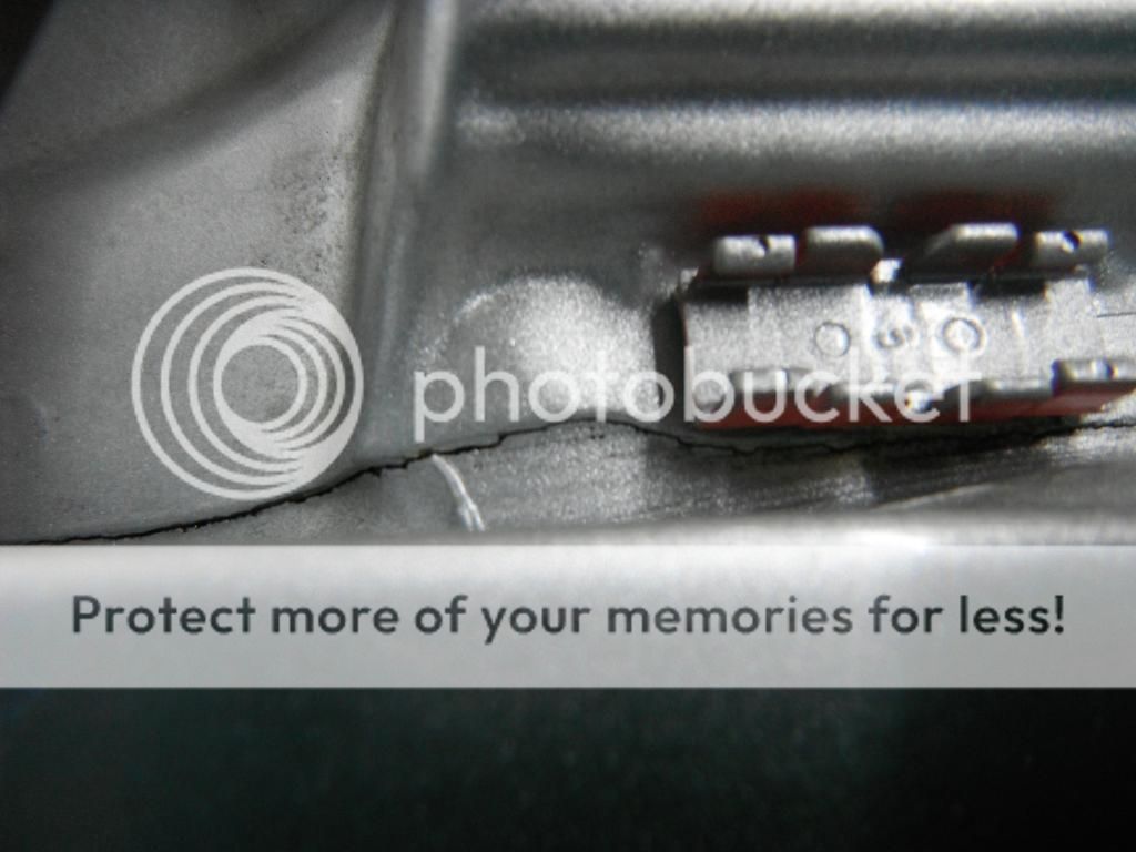

    2004 Prius right rear corner

    Neither has leaked yet....after I used some clear silicone. The silicone probably won't last but time will tell.

    Thanks for posting those pictures I really appreciate it. Can you post pictures a little farther out so I can see where these cracks are located in relation to the rest of the car? I don't know what a trim stripe is for example so I'm not sure where to look. Thanks!!!

    If you look at your car roof there are black plastic strips one on each side. Pop the rear part of the strip off at the rear of the car.( it pops straight up very easy) then clean the area around the little metal clip very good. I used 409 cleaner and a old toothbrush. The 409 cleaner was only used because it was handy. Then I used compressed air to blow the area off. If you don't have compressed air use water in a spray bottle and let it dry. Look very close because I missed the crack the first time.
