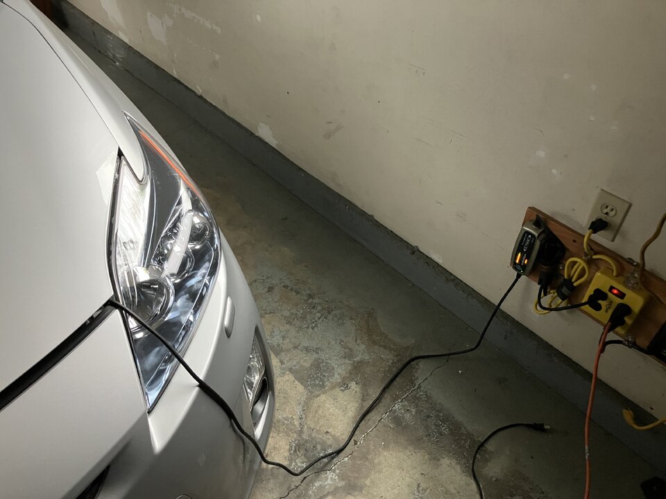

    What's your parking situation? Do you have secure, off-street parking with 120 volt AC outlets available? If so,l look it smart chargers, around 5 amp rating, either on-board or exterior to the car, depending on the situation: if you're parking outside an onboard charger is more secure, just a power cord protruding from grill (like a block heater cord) is the usual setup. If you're in a secure garage you could also use an exterior-style charger.
    My setup:
