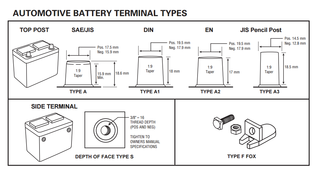

    A Prius battery has really thin JIS pencil posts, whereas most batteries have more substantial, SAE posts, so the connectors may not be able to be tightened enough to be secure.
    Your C-10 may have another odd battery, with side posts, so be even harder to adapt to work.

    Looking up a 72 Chevy C10 battery, it is a Group 78 battery that has somewhere around 800 cold cranking amps. The Prius 12 volt battery is Group S46B24R and has 325 cold cranking amps. The terminals are different and the Prius battery probably will not have enough capacity to do the job.
