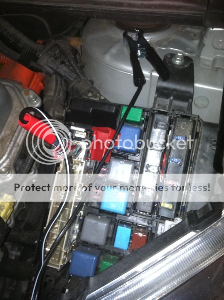

    I replaced my original Denso 12V battery on my 2008 Prius (09/07 build, 11/07 purchase) in October of 2012. The original battery was reading around 12.0V in maintenance mode, and users here had suggested that I go ahead and replace it. I replaced it with an Optima Yellow Top, and it was suggested that I give the Yellow Top a full charge before installing it, because of them being sent out with significant discharge. (I never did this) After ~ 4 months of driving, I did another maintenance mode test on the Optima, and it is reading around 12.0V unloaded in maintenance mode. I recently purchased a Schumacher SC-600A battery charger, and wanted to know if it was safe to charge the 12V battery through the front terminal, at 2 amps. If absolutely necessary, I can pull out the Optima, but my preference is to not. Any help is appreciated, thanks!!

    Yes, you can charge the Optima at up to a 10A rate. If you wish to use that higher rate (which means a higher charging voltage as well) it might be a good idea to first disconnect the battery negative cable where it attaches to the body, and hook up the charger directly to the battery. That will isolate the Prius electronics from the charger voltage.

    Since your charger has a 4A position, you can use that setting via the hood access. The 2A rate will be painfully slow.

    Btw the pos clamp is attached to the wrong place. You don't use the bolt head in the fuse box. That bolt is holding the attachment tab you should use. Its the little vertical aluminum tab just above the bolt in the picture.

    Ah, I see that, and it makes perfect sense, because I was asking myself how larger clamps would ever be able to clamp to that bolt head, the clamps on the battery charger are tiny. Thanks for the heads up!
