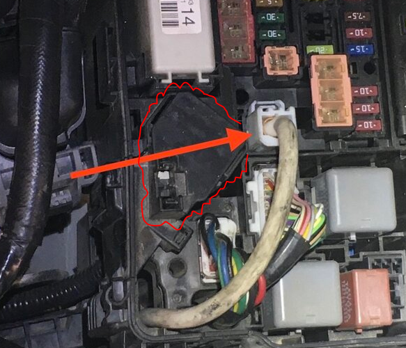

    Rather than that answer (which will make it difficult to access with the hatch dead), I might disconnect the white cable in the engine fuse box. Easier to access later.
    Personally, I just carry a Lithium jump pack under the driver’s seat.
    Finally everyone has trouble posting pics direct unless you use an online file server like Google drive or have the secret multistep process which requires JavaScript to be on then off then on with a desktop mode enabled on your iPhone.
