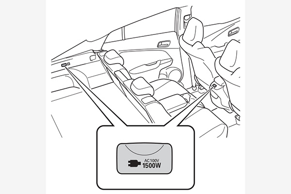

    Yap, those are standard options available only in Japanese Prius PHV, not for Prius Prime in US. Though I don't know about other countries. My understanding is that Toyota implemented those options in reflection to numbers of natural disasters that hit Japan in recent years.

    Yes, at least one other thread on this here. Would be a nice option in the States for similar reasons. Also car camping and tailgating stuff.
  4. bisco
    114,651
    52,373
    cannot be retrofit to n/a models

    This plug/ or adapter is for immediate use from the built-in inverter in the Japanese products. For emergency, camping, whatever., I believe. If someone reads ideographs, please contribute.

    That orange thing from Japan? I think there must be circuitry associated with the outlet inside the car. The car talks to whatever you plug it into. It doesn't just connect any passing leads directly to that, 200 Volt(?) battery. I think the orange thing talks to the circuitry associated with the company inverter and the inverter in turn persuades the traction battery to connect.
