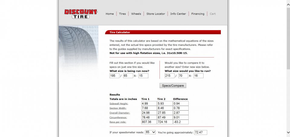

    From Discount Tire site:

    why would you want to put a set of tires that are 3 inches bigger on your brand new prius? I am sure it would be dangerous if it even fit, which I didn't measure but I doubt. You can get a used set of wheels and new Michelin Winter tires to fit your prius for under $600.
