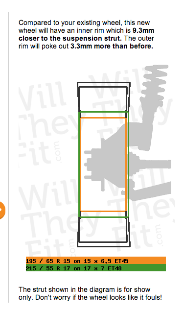

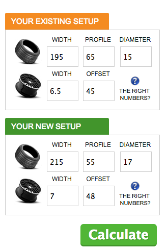

    Hey guys, just wondering if anyone has seen BRZ wheels on a Gen 2 prius? It seems to me like they'll both work/fit decently considering:
    Screen Shot 2014-08-20 at 10.13.41 pm.png Screen Shot 2014-08-20 at 10.13.55 pm.png
    Not too worried with the speedo thing, I drive with a GPS on which I use to gauge my speed anyway

    The Gen 3 needs a 3mm spacer to clear the brake caliper holder on the rear, IIRC. Don't know about whether the Gen 2 has this issue.
    Hubcentric rings will be needed on all four wheels because the bore size is larger on the FRS/BRZ wheels.
