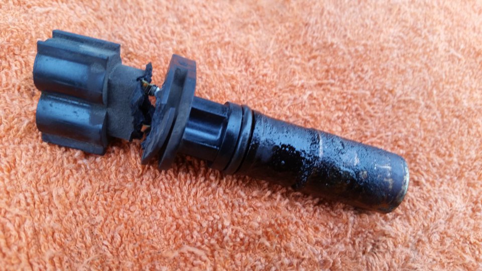

    While I was digging around I noticed this and took a picture to share. My guess this might be my reason I'm getting a P1346 code.

    Brakes are working great. The job was far simpler then I thought after all. After installing the new Crankshaft Position Sensor. I cleared the P1346 code. It came back as a pending code right away. Looks like the sensor being broken in half wasn't the cause. I'm going to look at the Camshaft Position Sensor to see if it's good.
