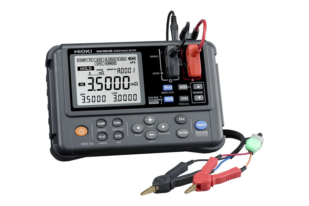

    Hard to practically test a 193.6 milli-ohm resistor without a milliohmmeter, a specialized instrument not everyone'll have lying around. Here's one that Toyota recommends for jobs that need that kind of test.
    (Notice the double-wire, source+sense test leads with Kelvin clamps, to eliminate the test lead resistance error that you normally don't worry about when measuring bigger resistances.)
