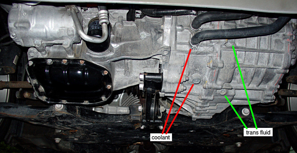

    The transaxle has a drain hole and a fill hole, you check the level by sticking a finger in the fill hole.

    Please describe Exactly where is the fill hole sooI can find it?

    Again you might want to explain what is actually happening as an ATF change doesn't do much in the Prius. But the hole and bolt is close to the middle in the vertical dimension of the transaxle. The procedure is NOT a flush, it is a simple drain and fill.

    I think you are off base, but here is the answer you failed to google.
    This nice man has detailed instructions on how to do a ATF change. Toyota Prius: How to Change the Transmission/Transaxle Fluid - PriusDIY.com
    This may be the single clearest photo (by hobbit)
    (the upper plug is fill, the lower plug is drain. Always open fill first, you would hate to have drained the fluid only to discover you could not fill it back)
