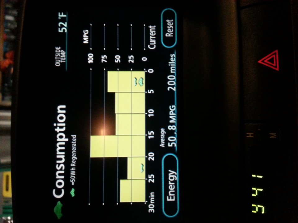

    2nd tank after putting tires up to 49/45 ( max is 51 on the Ventus ) replacing the battery and cleaning the MAF.
    My mileage is 47.2 :) :) (up from 38 to 39 mpg )
    I used my micrometer and checked the tread depth to 10/1000 of an inch on the inside/middle/outside. I will track that and see if they are wearing evenly over time. Not wearing out the center.
    My son put his 2005 Prius Michelin Energy saver AS tires up to 42/40 ( max 44 ) and his mileage went from 41.7 to 46.7.
    Not bad for winter gas.

    Had Seattle trip. Portland to Seattle with 26 miles around town before trip. Driving speed limit including 70 mph from Vancouver to Tacoma with wife using cruise control. 48.1 mpg. Trip back 60 mph no cruise control 50.8 mpg on winter gas. 20140309_214232.jpg
