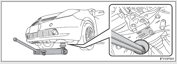

    Do you have the owners manual handy?
    If not, this image might help.

    Exactly as you say. I couldn’t find the point shown in the pic posted above. The one you are suggesting, would you have a pic

    You should be able to identify from the details in that pic. I was going to say “jack it up for a better view”, then caught myself lol. I’m pretty sure it’s a central point on the main lower support beam, as far back as the front wheels. Get a good light under there, roll the jack in from the front and look from the side. Aforementioned low rise ramps would help a lot.
    I made these out of 2x4 on edge, but something like 2x8 layered on flat would be simpler (@jerrymildred maybe will post the latter style). My style:

    This image shows the two jack points for a trolly jack in the center – the green circles – and where to place the jack stands (if required – the red squares.
    Right at this moment, I'm finding it hard to visualize the points for the stands, but the green circled points are the ones I use for my floor jack.
