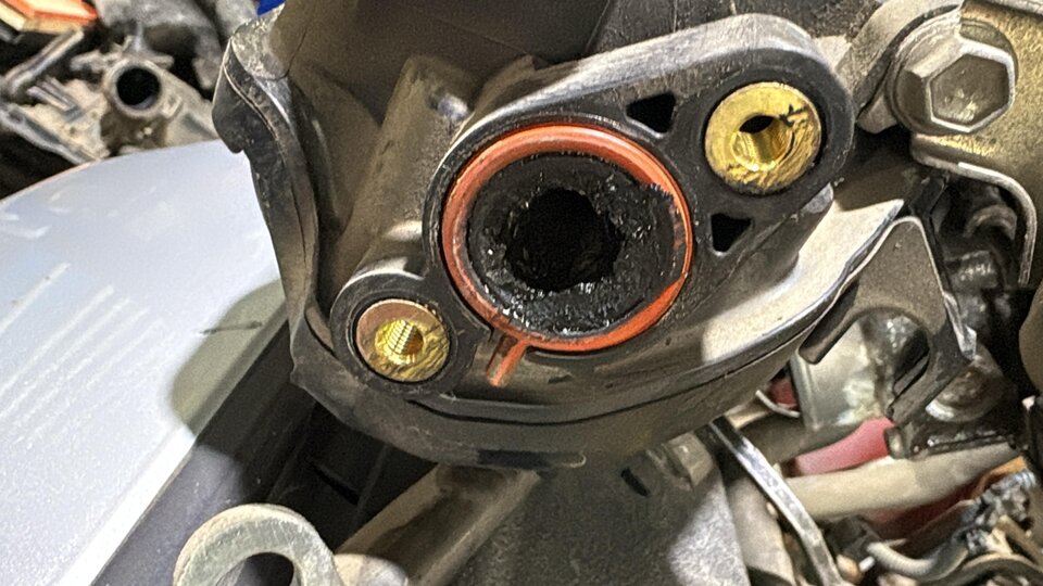

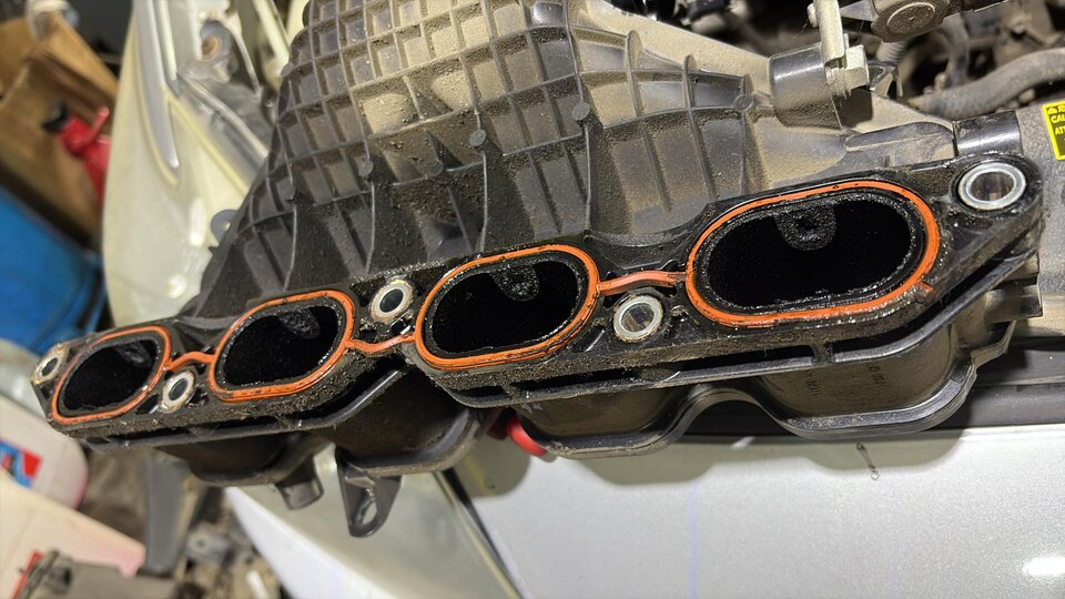

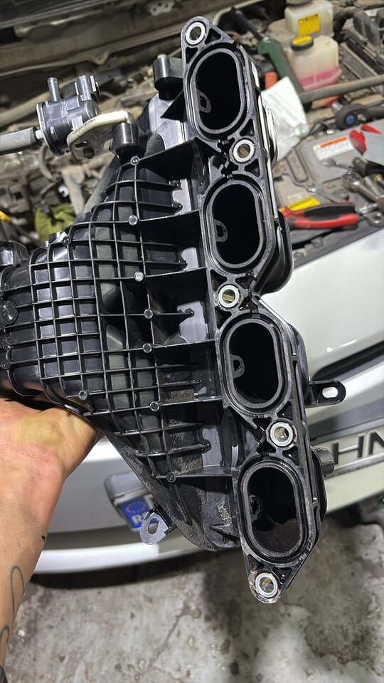

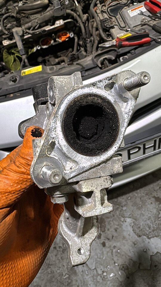

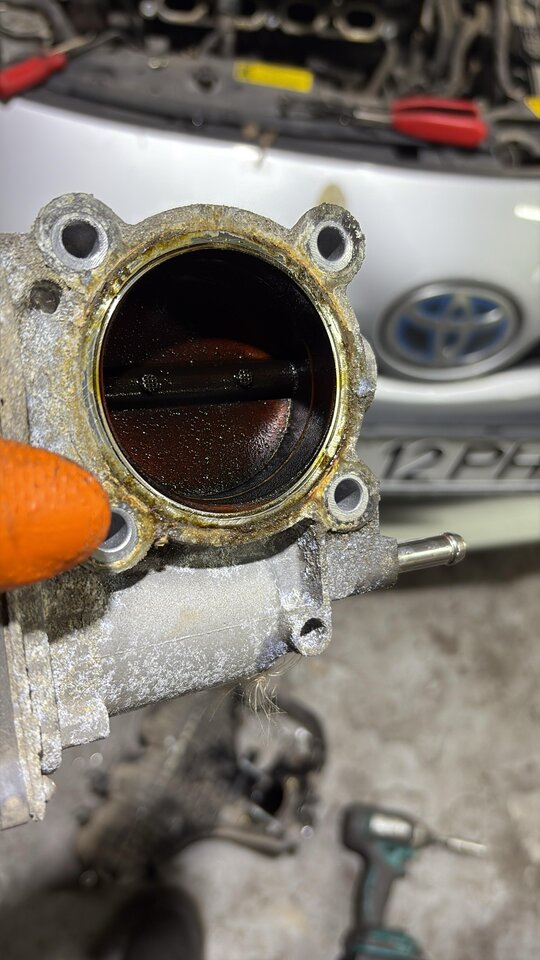

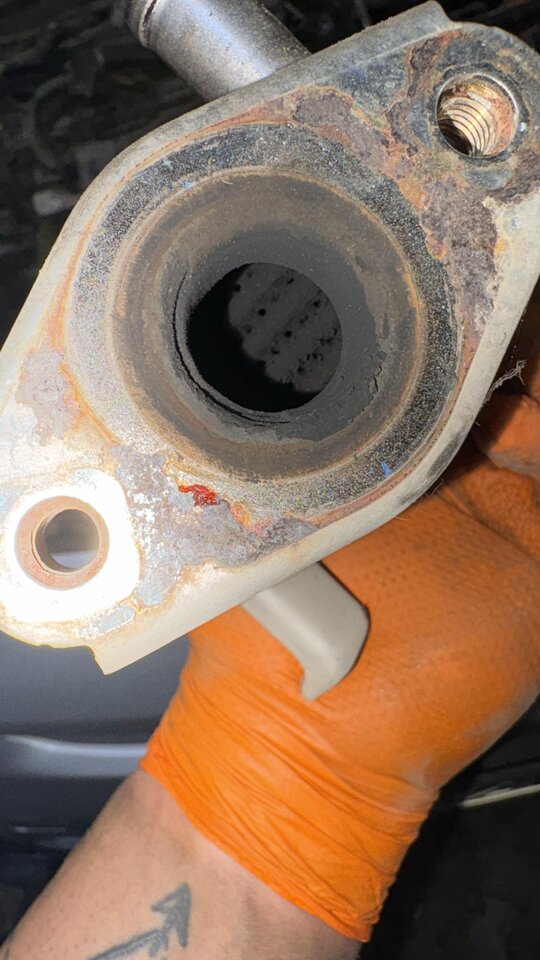

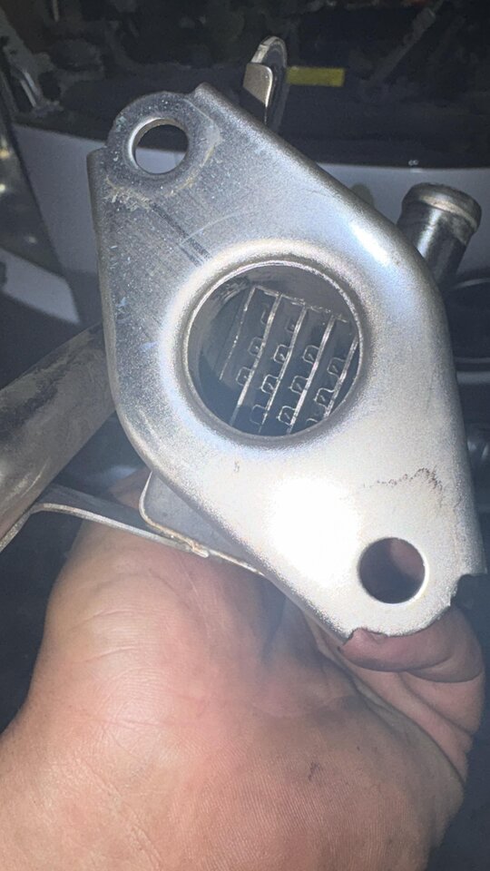

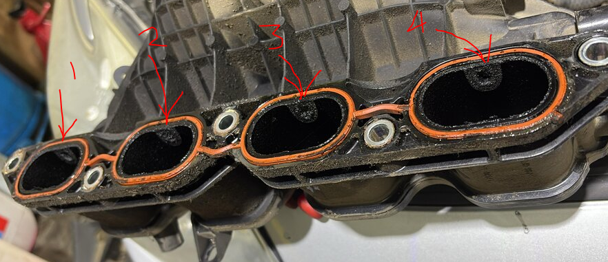

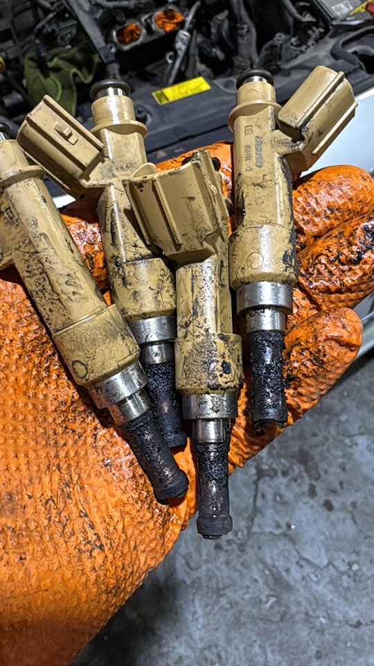

    Anyway, it seemed to only have one code stored - P0401, the dreaded EGR insufficient flow code. I went ahead and took it to a mechanic that knows his stuff around hybrids and of course, the EGR, cooler, fuel injectors and intake manifold were full of junk :
    WhatsApp Image 2025-05-14 at 12.38.31_3fd892bd.jpg WhatsApp Image 2025-05-14 at 12.38.31_23270f87.jpg WhatsApp Image 2025-05-14 at 12.38.31_a1978ea9.jpg WhatsApp Image 2025-05-14 at 12.38.31_fd1dbc2d.jpg WhatsApp Image 2025-05-14 at 13.24.10_3707a4f1.jpg WhatsApp Image 2025-05-14 at 13.24.11_b5dd69e8.jpg WhatsApp Image 2025-05-14 at 13.24.11_f39cebe7.jpg

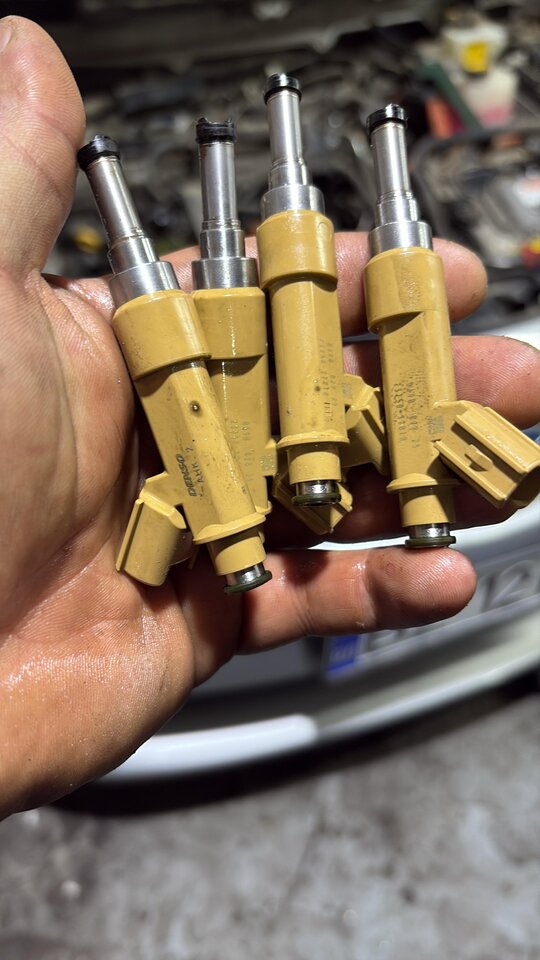

    But not a worry, the mechanic took care of it : (uploading pics just in case somebody wants to see a before and after)

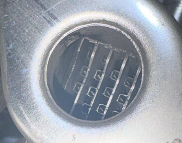

    WhatsApp Image 2025-05-14 at 15.03.27_42d43dd5.jpg WhatsApp Image 2025-05-14 at 15.03.27_42089b03.jpg WhatsApp Image 2025-05-14 at 15.03.28_700ac7fe.jpg WhatsApp Image 2025-05-14 at 15.03.28_f60af247.jpg
    Paid the man, drove the car home. No check engine lights; Car was performing very similar (didn't notice any performance issues even with the code) - maybe just a tiny bit smoother and less noisy.

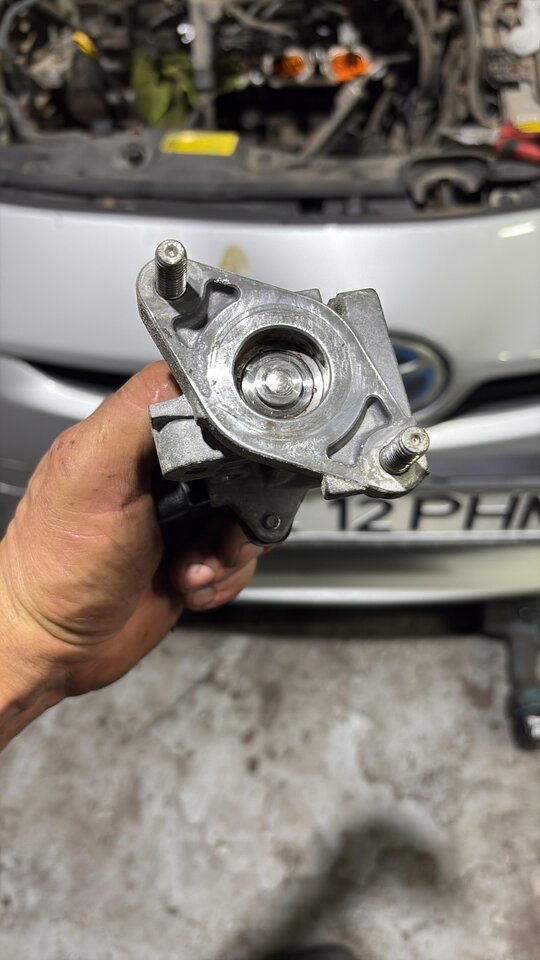

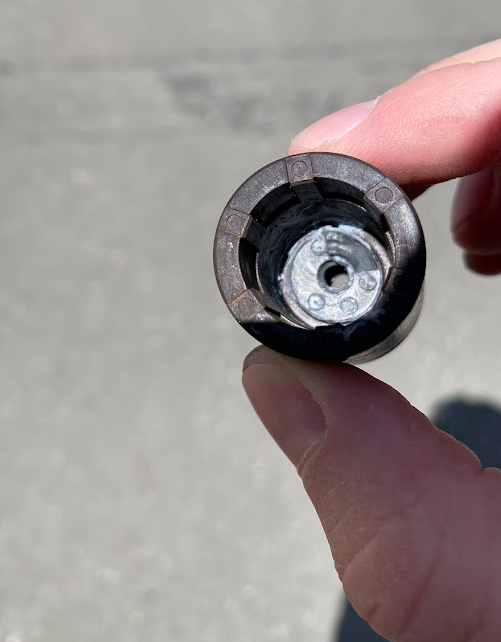

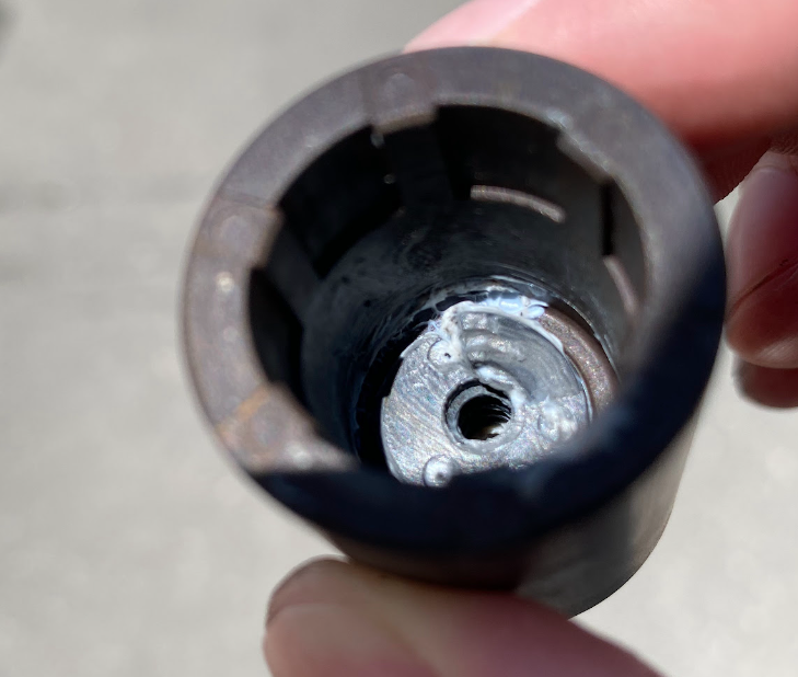

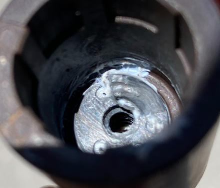

    I read the huge thread that found the "ski jump" plastic bit inside the valve rotor to be the culprit. Went ahead and took it apart :
    It looks fine to me! It certainly is not as smashed as in some pics I have seen on that thread. The valve itself also operates smoothly by hand.
    I have also checked MAP values, 35 kPa at idle seems to be in line with what other guys were getting, so I'm assuming the MAP's fine as well...

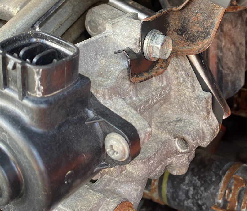

    So what else could it be? The only other suspect I have would be that the mechanic somehow messed up some gasket installation:
    I'm refering to the gray - black gasket between the valve and the cooler itself. I'm thinking that shouldn't sit like that - maybe that's what's obstructing the flow! But then on watching some YT videos... it looks the same there.. And also, I don't see how you could screw that up, looks like it can only be installed in one position since it's held in by 2 bolts...
    I've no idea what to do next. Can the stepper motor be bad ? As in, not functioning at all? I'm assuming that would've caused other problems.. like rough idle, rattling..

    ^ I'd say that's not fine. Optimum would be to replace with new EGR valve. I've a hunch that the more clogged the system is, the more that valve mechanism has to work, exacerbating the wear. That damage "may" be the cause of the ongoing P0401.
    ^ While commendably cleaner than the "before" disaster, you can goet those like-new clean. What cleaner or technique was used. Corking one end and pouring in a caustic solution and letting it soak, rinse and repeat, will get the stubborn remnants.Low intensity would be Oxi-Clean Versatile Statin Remover (powdered laundry additive), as concentrated as you can make it. Or lye. I've not used the latter but suspect it's very effective and fast.
    ^ The condition of those EGR orifices is very telling. Any exahust gas that managed to get through the cooler/valve/pipe would have hit the wall at that final hurdle.
    All-in-all your guy did a pretty commendable job: if you don't mind, what did he charge?

  4. ChapmanF
    26,218
    17,174
    Yes, that right there is a ski jump with a rut right through the middle of it. So when closing the valve, the rotor goes right past the point where the valve is closed, and only stops when it is would up tight on the pintle threads. Then when the ECM wants to open the valve by so many steps, it counts rotor steps from there, and the valve will never be as open as it should be.

    On the other hand, a rut gouged through the "ski jump" stop on the inside of the rotor is a common and definite problem, and the photo that you posted in #1 definitely shows that it's a problem you have.
    So, I would probably recommend to relax about possible worries somebody somewhere may have circulated about threads, and focus instead on the definite problem your own photo shows that you have.

    As for what cleaning products were used, honestly, I have no idea; all I know is that the injectors were cleaned using ultrasounds. But I'll ask the mechanic anyway and report back if he provides an answer!
