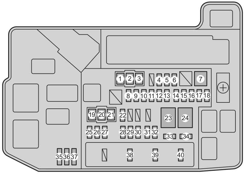

    Before the thread goes off in two different directions, which fuse exactly are you replacing and calling "the AC fuse"?
    Is it this three-in-one fuse numbered 1, 2, 3 in the underhood fuse box? That's for the blower (or at least segment 1 of it is).
    Or have you been replacing the high-voltage fuse under the L-shaped inverter access panel?
    That one's for the compressor.

    No, that one under the dash does not power the blower motor (that's the three-fer fuse in the underhood fuse box). So the issue here isn't excessive power running the compressor (that'd be the high-voltage fuse under the inverter access cover) or the blower motor (that'd be the three-fer).
    This A/C fuse just supplies the incidental power to the rest of the HVAC bits, so, the ECU, the controls and display, the solar vent relay if you've got the solar deal, and so on.
    It does supply the low-voltage, control side of the compressor too. The compressor gets its working power from the orange high-voltage cables, but its electronic bits are powered from here. Purple wire to pin 6 of the low-voltage connector on the compressor, which faces up. People have reported some problems with water and that connector. That circuit might be a likely suspect if driving through puddles seems to be involved.
