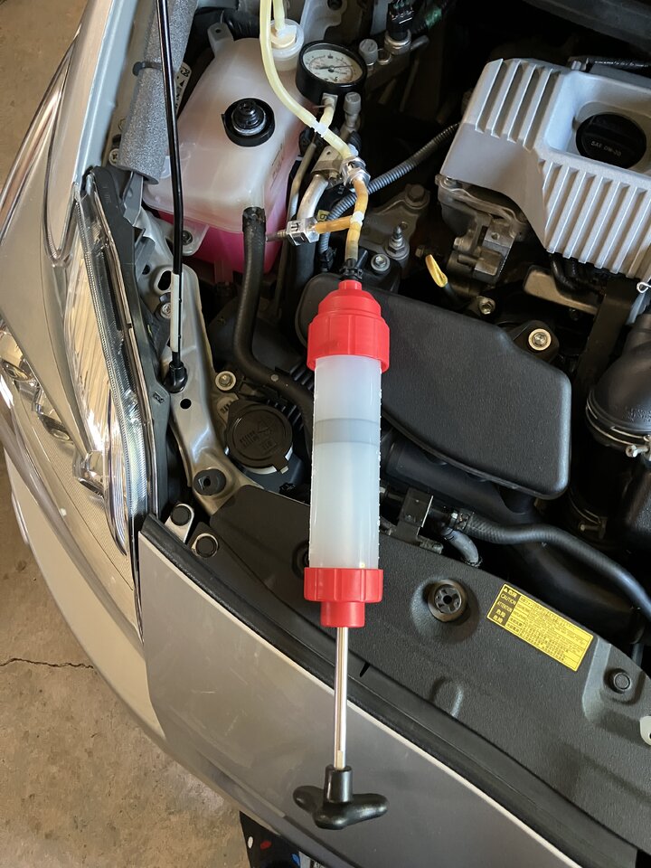

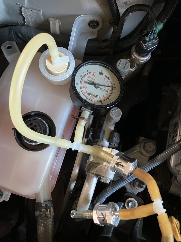

    You did "EGR service several years ago": this was DIY? Did the intake manifold with it's EGR passages get cleaned as well? Can you recall the miles on the odometer?
    To check head gasket, on the day after car's been driven, pressurize the engine coolant system (remove reservoir cap and install stopper of some sort and apply sustained air pressure), remove wipers/cowl and spark plugs*, and run borescope into combustion chambers, looking for exceptionally clean piston top(s), coolant weeping from head gasket seam.
    diy coolant pressurizing gizmo:
