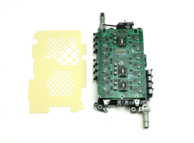

    There is only one "inverter" (sometimes called inverter/converter). There are replaceable boards inside the inverter including a power transistor module that can be changed.
    The inverter does things like providing power to and from the motors, ac compressor, hv battery, 12v battery, etc. Its is also programmed with updated software. In the end it is an essential system that is sometimes replaced whole (fastest procedure) or internally repaired.

    There is only one "inverter with converter assembly", but it has several internal parts that are separately replaceable, including a transistor module, an MG control computer, and a current sensor. Generally the transistor module will be what fails, but depending on the exact circumstances, it can take other parts with it.
    The dealership will be following T-SB-0036-16 to do the repair.
    The first thing they will check (just by looking) will be whether the failure actually damaged the inverter's metal case. If it did, you get a whole new assembly.
    Otherwise, they will follow the steps in your model's Repair Manual (more info) to determine which internal components have been damaged and need replacement, and do that.

    Of course the procedures for internal repair are much more like computer building than car repair; I'd almost rather take it, with the instructions, new parts, squeegee, and heatsink compound, to a gamers' convention than to a car dealership.

    I don't believe there's any soldering involved. Just a lot of, ideally, near clean-room work, separating the case, cleaning off old sealant and heat-sink compound, applying new heat-sink compound to very exacting specifications, getting it all properly reassembled and sealed.
    Interestingly, the IPM transistor module seems to include the water-cooling heat sink and coolant plumbing. The heat-sink compound goes between the bottom of that and the top of the DC/DC converter, which lives in the very bottom of the case and is cooled by its contact with the IPM's heat sink.

    The transistor kit is a single big flat IPM brick that includes the IGBTs, driver circuits, and an aluminum heat sink with coolant pipes in and out. It gets replaced. There are no steps in the repair manual for solder-happy techs to go at it with IGBTs from alibaba.
    The module bolts down inside the inverter case with four bolts, and the electrical connections are five bolted connections to busbars, and plug-on connectors for the control electronics (two connected in step x, and the yellow thing in the middle of the board looks to me like a header that will mate with the MG ECU, which is the board next installed on top of this one).
    Those are just steps w, x, and y. They're preceded by seven pages (seven pages!) about getting the heat-sink compound properly applied on the converter module this clamps down to, and followed by eighteen more pages of reassembly (bolting the MG ECU back on and plugging in some connectors, putting the terminal and sensor assembly back on and plugging in some connectors, and about ten pages of getting the case reassembled with the form-in-place gasket properly applied and sealed).
    If you didn't watch the tech that did yours "desolder the igbts", I call BS on the tech telling you they did that. If you did watch it happen, the details of what they did would be very interesting here, and go completely beyond the 34 pages on IPM assembly installation in the repair manual.
