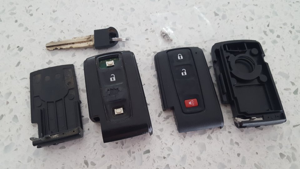

    I also recently changed the battery in the fob

    We've had this happen on 2 of the 4 Gen 2s that we've had in the family. Each time it was solved by pulling the fob battery out and using the spare fob. We then replaced the fob case, cleaned the circuit board and installed new battery in the previous fob.. The suspect fobs had holes worn in the buttons and we think dirt/dust had gotten in them causing the buttons to be sticky.

    You don't need to replace the entire fob if the buttons are worn. You can buy a new fob case and transfer the guts from the old case to the new one without the need for any programming. The case costs about $13-14 bucks and is easy to change. I bought mine on Amazon and it works fine. The only differences I saw were that the new case had a matte finish instead of gloss and there was no Toyota logo on the back of the new case. I used my old back with the logo and it fit perfectly.

    Do not forget to transfer the RFID chip if the case is replaced.

    Switched over the electronics w the $10 replacement and everything seems to work fine. Not sure if it'll solve my alarm issue so we'll see.
    *Watched a few videos and since there has been problems from prying (and damaging) the circuit board, I released it from the fob by pushing from the button side.
