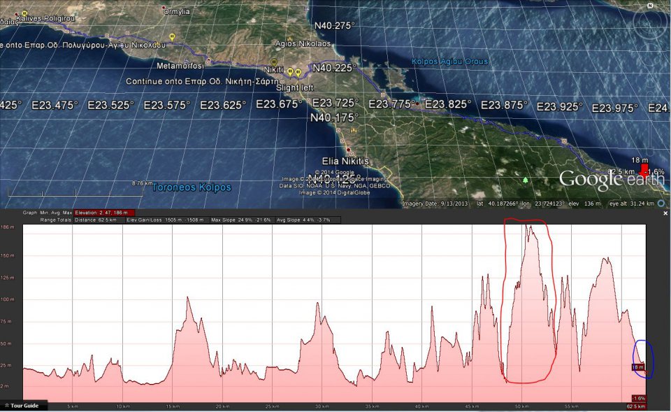

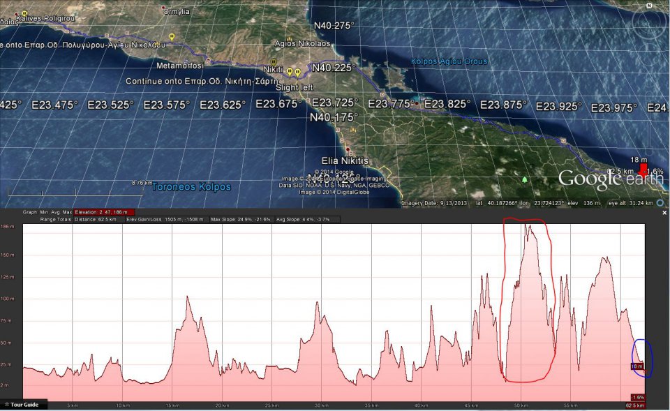

    The map is perfect! I've ported it to Google Earth so we can see the elevations:
    Based upon the elevations, I recommend:
    • Descend tallest slopes, >30-40 m, in "B" - this will minimize traction battery heating which can be severe in the Eastern part of the route. Since this turns off cruise control, shift between "B" and "N" on the descents to maintain an optimum speed. Use of "D" is OK but "B" and "N" are your best bets. A cooler battery is a longer lasting and more efficient one.
    • Starting from Eastern end on a 'cold start' (first use of the day,) start the car but let it idle until it shuts off the engine by itself, ~70 seconds. This means the engine and catalytic converter have reached self-tuning, mixture mode and the subsequent hill climb will be efficient. The Western section , cold-start is not so sensitive because it is level.
    When climbing, I like to use large trucks as a 'pacing' vehicle. It means a slow, efficient climb and following traffic will blame the truck for the slow speeds. <GRINS>
    GOOD LUCK!
    ps. Don't make a fetish of this style of driving. But it has some solid engineering data behind it if you are interested.

    It's unclear to me how slow you have to go during the warmup cycle to be on the electric motor only. My indicator lies, it shows ICE is used even if I go one kph lol! I read if you exceed some magic threshold load it will use the ICE, yikes. So if I can't literally crawl at 15 kph for about 50 sec (this is how long warmup takes here with ambient temps > 30 C) I warm up stationary.
    Regarding battery heating, is it that big of an issue that it's better to get say 50% charge with light regen rather than 100% indicated (it's not truly 100% as we know) charge? On a 500m descend I often go through I definitely use B and still get a full charge by the time I'm down :) I guess it's better to get a slow regen charge rather than a quick one.

    The engine has to run during warm-up so let it but at a minimum load. There are three critical temperatures:
    • ~50 seconds - the O{2} sensors start working and the engine controller can tune for an optimum fuel mixture.
    • ~40C - the engine can auto-shut at a stop or slowing down.
    • ~55C - the engine can auto-shut and use traction battery power when the load is low enough.
    But it turns out the first use of the day is the 'cold start' (not counting winters in Northern climates.) There is some residual heat that helps subsequent trips.
    Heating the traction battery was a problem with the first NiMH cells and modules. What happens is in hilly country, the descents cause exothermic, a chemistry based, heating. Then driving up the hills so hard that the traction battery charge is drawn down contributed resistance-heating. Do enough hills at high speeds and the traction battery can get not just warm but hot. To reduce heating:
    • Use "B" on descents and alternate with "N" and "D" to 'feet on floor' control the speed.
    • Back-off on drawing traction battery power ascending hills so it won't force unnecessary charging.
      • Use a heavy truck ascending a hill as a 'pacing vehicle'
    You might consider getting a Prius-aware scanner, one that reads the traction battery temperatures. This will let you see what is going on with more details than our mumblings in PriusChat.
