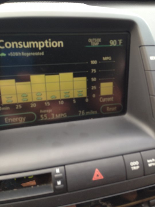

  17. sanlen
    sanlen Junior Member
    Dec 14, 2010
    42
    Phnom Penh
    Hi All,
    Thank you very much for all comments.
    Last Sunday, it was the first time that this car run on highway. I always stayed below 60 mph and as result i get the consumption as attached.
    I am happy with the performance actually, however, i wonder what does the meaning of the small green (50Wh Regenerated) icons within the yellow bar? I rarely see this icons while i am in city. Prius.JPG Prius.JPG
  18. dolj
    dolj Senior Member
    May 14, 2012
    8,209
    4,180
    Wellington, New Zealand
    Each full car symbol represents 50 Wh of electricity regenerated in the 5 min period. Your 0-5 min bar shows you regenerated 75 Wh and your 15-25 min bars show you regenerated 100 Wh in each 5 min.
    Yes, you do tend to see this more cruising on the motorway, or if you have a long-ish down hill gradient where you need to hold your speed with regen/braking, or lots of slow braking for traffic lights. There tends to not be the same degree of opportunity around the city.
