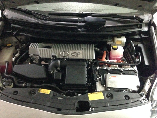

  11. Mendel Leisk
    60,878
    41,901
    3rd gen prius engine bay, at 43000~ kilometers. But wait: no pressure washer, no solvent running down the curb to storm drains and into streams. Just very occasional blow-out with a wet-dry vac and a leaf blower, coupled with various brushes to get in the corners.
