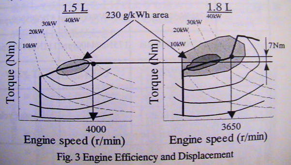

  19. fuzzy1
    17,813
    10,602
    This chart doesn't include the Gen1, but clearly shows ever-increasing power at increasing RPM for the Gen2 and Gen3 engines:
    2010 Prius 2ZR-FXE engine efficiency map | PriusChat
    Perhaps he was thinking of near-maxium engine fuel efficiency, not maximum power. Though max efficiency for the overall system doesn't necessarily line up with the max efficiency for just the engine or other components.
    Tideland Prius and John Dadmun like this.
  20. ChapmanF
    28,012
    18,526
    I suspect that is what he meant and that makes good sense in context; I just didn't want to leave a post uncorrected saying max "power" at 3500, lest somebody else read it later and cite it somewhere else, and poof! a factoid is born.
