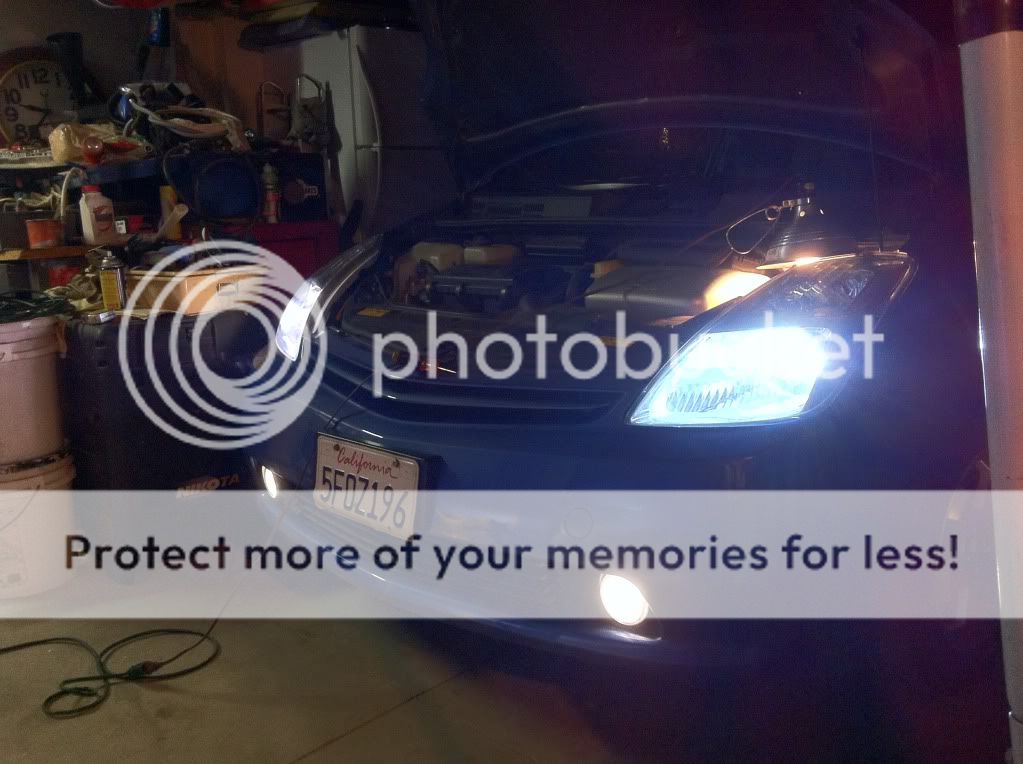

    Alright, I'm posting these because I said I would once they came in.
    Drove down to Huntington Beach and got my 6,000k 35w kit from DDM Tuning for my fog lights Monday afternoon. I ordered my Phillips OEM 6,000k bulbs from eBay. Those came in mid-tuesday (yesterday). Installed everything yesterday afternoon.
    Driver side done

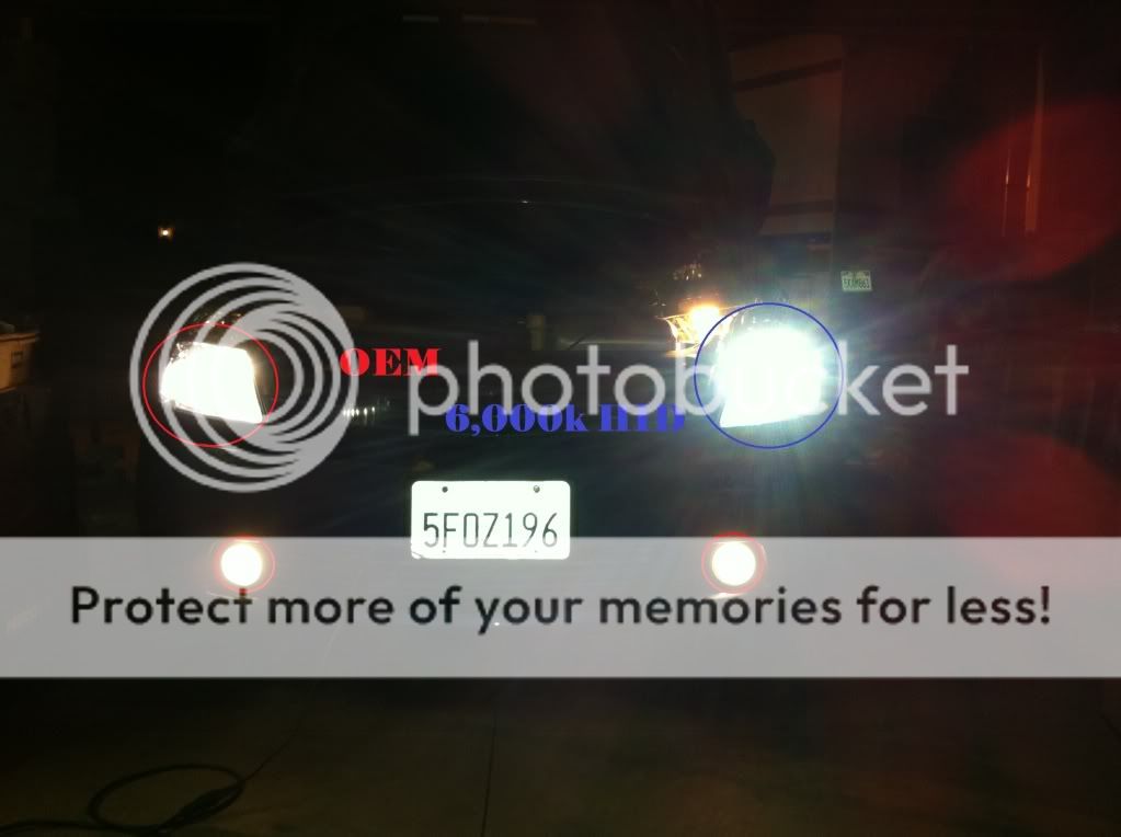

    <--- 6,000k
    ---> OEM 4,300k
    All 4 done

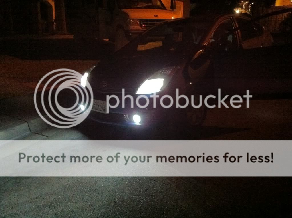

    Outside view
    It's really very difficult to capture the beauty of them at night. My iPhone 4's camera can only soak in so much.
    2 people like this.

    Looking at the pictures I am starting to think maybe the 6000k might be too blue for what I want. I had them on my GMC and Chevy truck and I remembered them being more white than blue. Do they seem more blue to you as well or is this due to the camera?

    Like on the 2nd to last picture? I don't know why they look so blue in that picture.

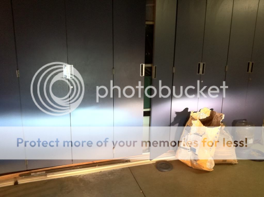

    Or on the wall where the light was hitting? Don't know why it looks so blue there, but the OEM ones actually looked pink versus the 6,000k's which looked more like a truer white.
    They really turned out exactly how I want.

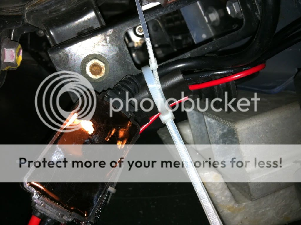

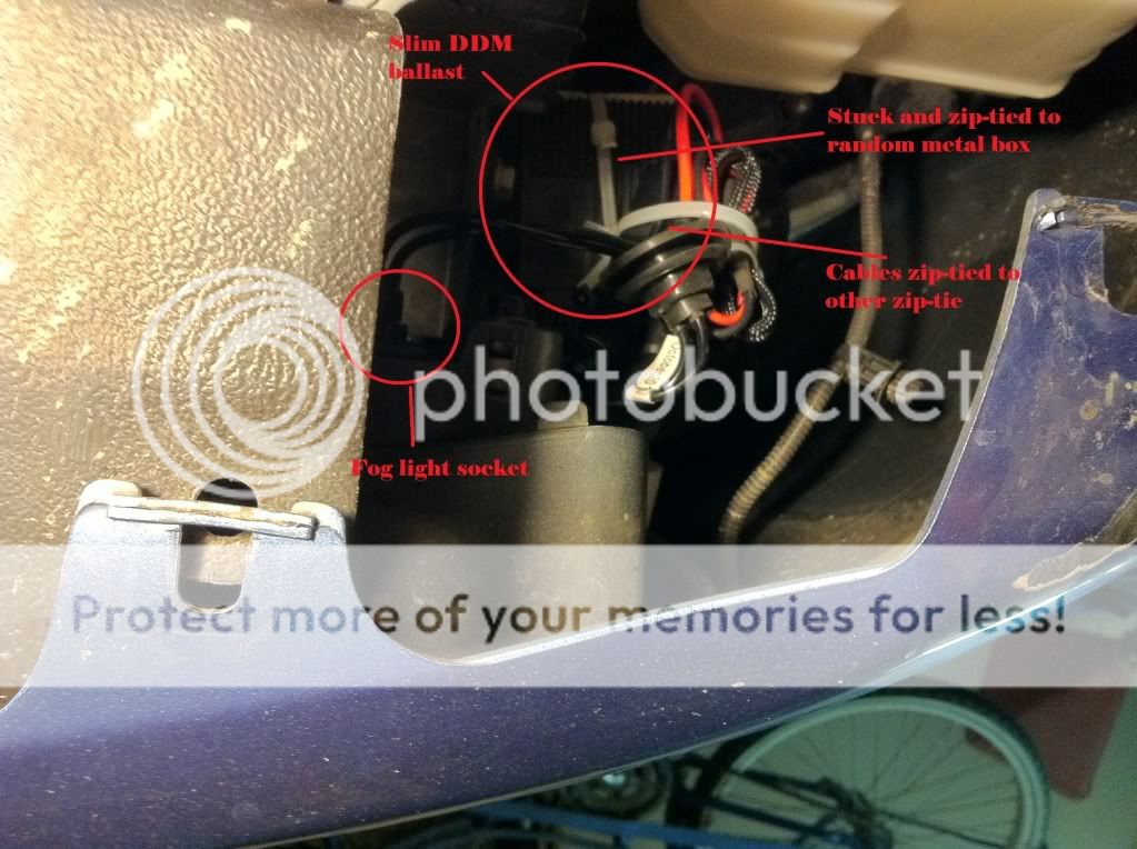

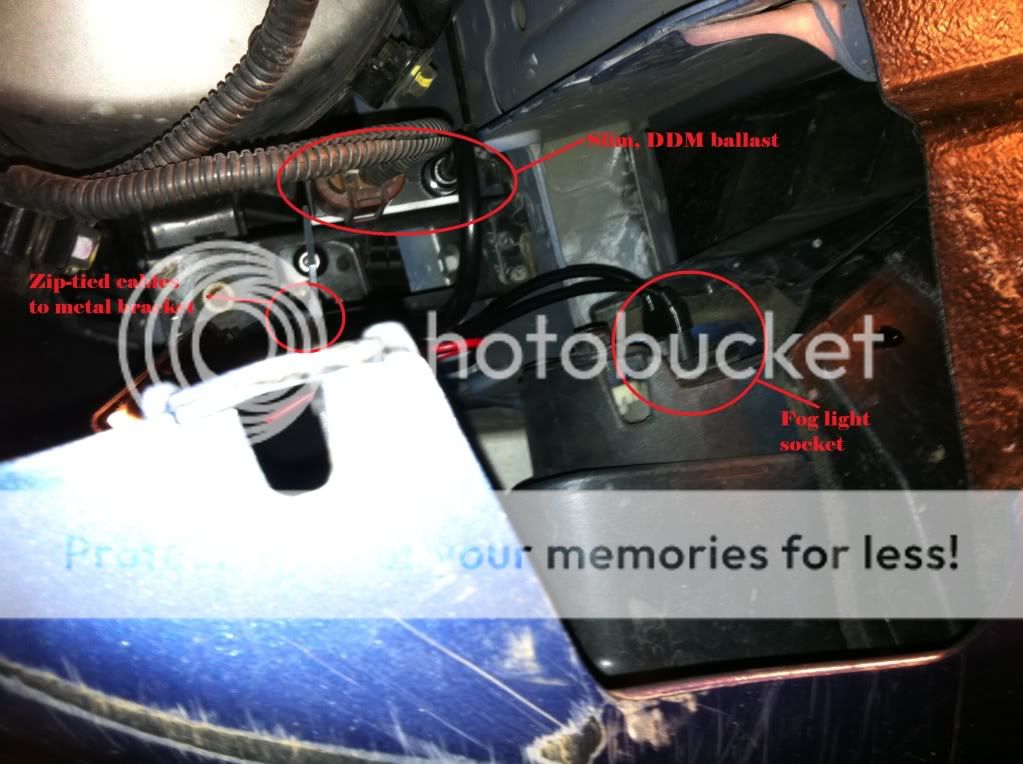

    The only little snag I ran into was with the ballast. You have to plug it into OEM male plug backwards from what you would think. You have to put it opposite from the clippy thing. It's kind of hard to describe, but if you end up doing it, you'll see what I mean.
    And generally speaking, the 6,000's do look a bit more blue than the 4,300, but o m g, there's a HUGE difference on the road. And because it was already manufactured to have HIDs, I don't have the same problem with my Eclipse where the lights go straight out and into the eyes of oncoming drivers. These actually hit the road in front of me. But of course, you can still turn on your brights and point the lights straight out, blinding everyone in a 1 mile radius. xD

    In pretty much all the pictures the light looked pretty blue. If it is not that blue in person then they may be exactly what I am looking for which is a vrey bright white light with a hint of blue.

    Did the OEM ones colour shift? They look purplish. I thought it takes longer than that (I've seen 1999 and older TLs with multi-reflector type OEM HIDs and those that still have the originals are noticeably light purple)

    They did have a slight purplish-pink tint to them when you looked at the actual light housing. When they hit the street, they looked more whiteish-yellow than anything. But like in the picture of the two different ones hitting the wall, they looked a lot more pink than the new 6,000's.
