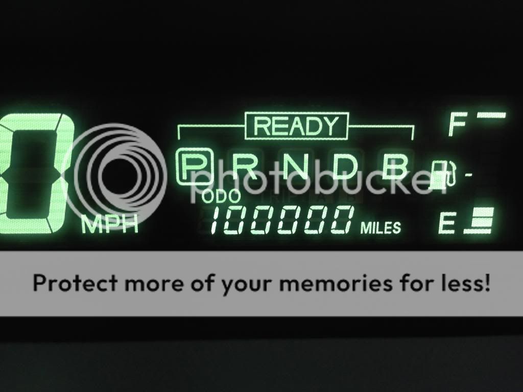

    Well, the matter came to a head last Wednesday when I was just 10 miles away from my first 100k (all my own miles, mind you) and the dash of my 2002 lit up like the proverbial Christmas tree... triangle of death and hybrid warning indicator. The hybrid system still felt fine with no loss of power, so I limped to the local dealer, and they did a battery of tests (so to speak!). The dreaded codes P3002, P3009 and P1636 came back (found these out after the fact when I looked at the invoice). The final verdict: The HV battery had not only failed, it had leaked and taken out the HV ECU with it. Total damage ended up being some $4,100, but being that the car is otherwise immaculate, I went ahead with the repairs, with the result that FINALLY, just today...
    Wait for it....
    100,000 MILES
    Woohoo!!!
    And she still drives as sweet as the day I got her... may she go for another 100k.
