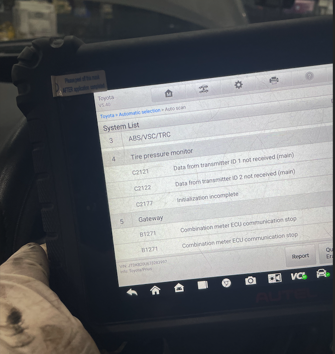

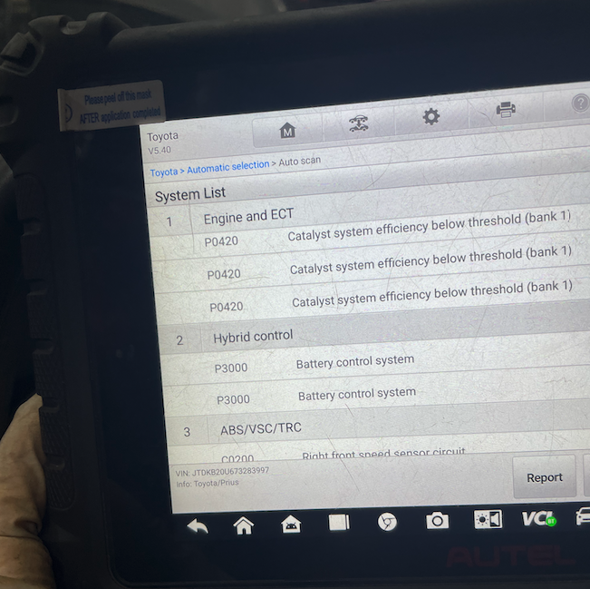

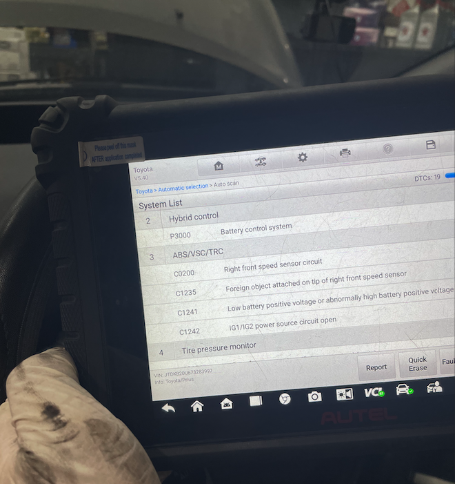

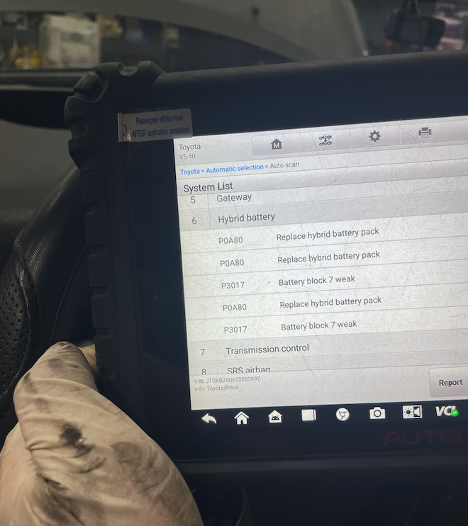

    I have briefly told you about my car and my story. Now, I would like to consult. I went to the mechanic today and had the error codes scanned. The images I have attached below show the error codes that came up. Here are the codes:
    • Engine and ECT:
      • P0420: Catalyst system efficiency below threshold (bank 1)

    1. P0420 The catalytic converter can be replaced by a reliable aftermarket model for about $125 and an hour of my time.
    2. P3000, P0A80, P3017 can be fixed with a quick rebuild of the HV battery. Probably three replacement modules (or less) and a couple days for disassembly, testing, and reassembling. A couple hours if it's just a rush job with minimal testing/capacity matching.
    3. C0200/1235 The right speed sensor is just dirty and needs to be removed and cleaned. 20 minutes and a 10mm socket. This is probably the one that's really messing up your driving because it's screwing up the skid control.
    4. All the TPMS codes? who cares. The sensors need new batteries, but create no driving problems. If desired, install new ones next time the tires get changed.
    5. The dash being dark is the typical combination meter failure and can be fixed by anyone competent with soldering. DIY for a few hours of time to disassemble the dash and a few dollars to buy new capacitors or get a replacement from Texas Hybrids for $150-200(?)ish.

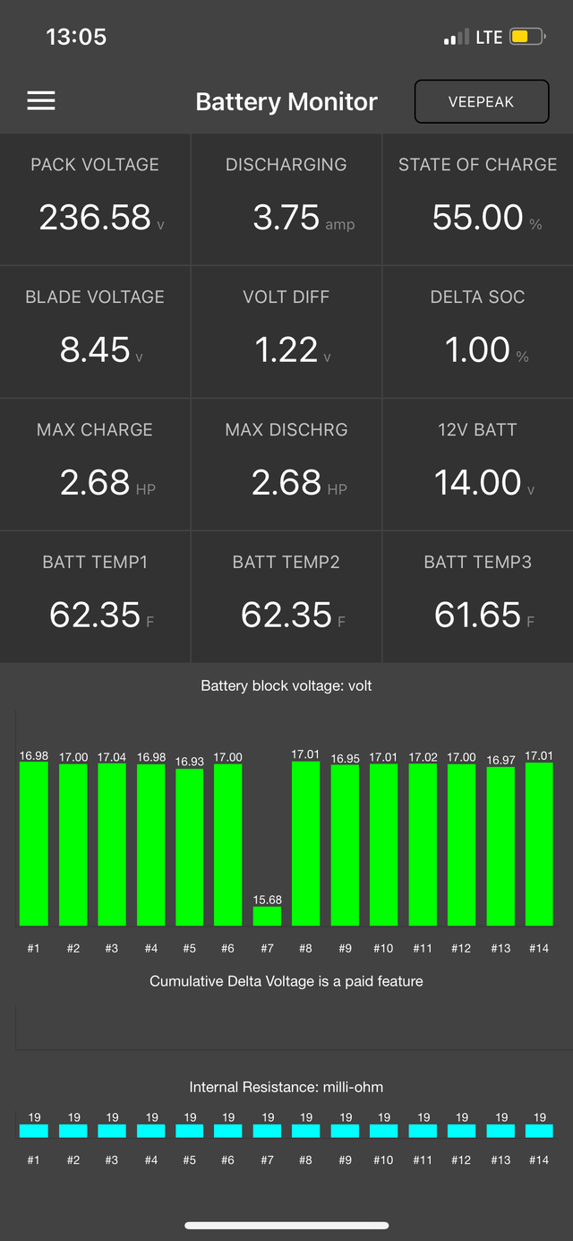

    Today, I bought a scanner for the hybrid and measured the values of the cells. They showed as follows, which I didn't quite understand, but I'll share with you in case you can give me some insight:
    • As far as I can tell, there doesn't seem to be much of a problem except for cell 7. I wonder if cleaning the fan might solve this P0A80 issue? Because it's not giving a red triangle error. It only gives a warning with an exclamation mark inside a car symbol, and the hybrid fan under the left rear passenger seat is always running.

    Cleaning the hybrid vehicle (HV) battery fan will not correct a P0A80 trouble code. Based on the P3017 trouble code and the screen print from the Dr. Prius app, you have a bad module in block #7. A battery block consists of two modules, and it looks to me like one of the two modules is bad. You can purchase a used module on eBay and replace the bad one in block #7, and it might fix the P3000, P0A80, and P3017 hybrid battery trouble codes.

    Correct. The answer to "How are the modules numbered in the HV battery " can be found by searching this forum. You also need to learn what Toyota is calling a "block".
    I will repeat what I wrote previously. There are two modules that make up block #7. One of the two modules is bad and needs to be replaced. I now add that you will need a volt meter to determine which one of the modules is bad by measuring the voltage of the module. The HV battery pack is comprised of 28 battery modules, all wired in series.
