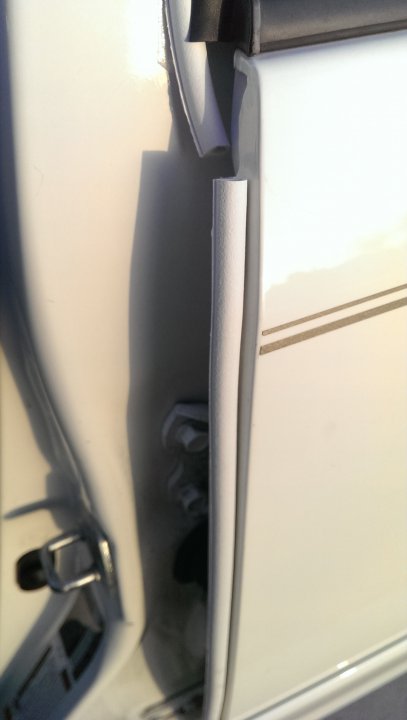

    Recently I have been doing a lot of highway driving with my 2007 prius. There is noticeably an excessive amount of wind noise at highway speed due to the gap between the front and back door.
    after applying a piece of weather stripping from the hardware store, about $5 the wind noise is greatly reduced. this is my 1st post so please bear with me.

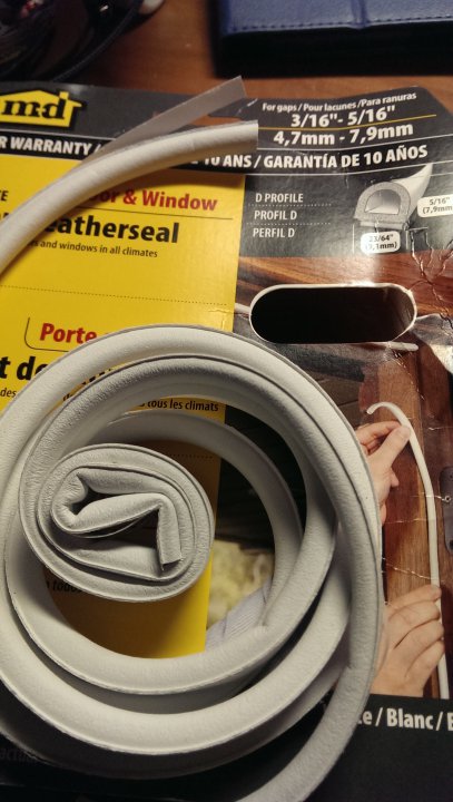

  5. B Rudner
    B Rudner Junior Member
    Mar 10, 2013
    The door seals are fine., wind noise went from a low howl to almost nothing at 70 mph. here's a picture of the product I used though I am sure any similar will achieve the same results.

  8. B Rudner
    Mar 10, 2013
    There were no seals on that part of the door. At high speed the air enters the gap between the front and back door in the gap .I found the wind noise very annoying . After applying the weather stripping it fills the gap and there is no more wind noise. It worked for me with very little expense and about 2 minutes time. Can I get the same results with OEM for the same price and effort? just thought I'd share .
  9. 2009Prius
    2009Prius A Wimpy DIYer
    Mar 25, 2009
    2,705
    512
    63
    Looking at OP's picture ... How was the lower strip applied? A piece of tape attaching from behind the strip and the back door?
  10. B Rudner
    Mar 10, 2013
    the weather strip I bought was a peel and stick . I'm sure you can just use two sided tape that can be bought at most auto part stores. Originally I bought the weather stripping to seal my front door. but it does make a noticeable difference.
