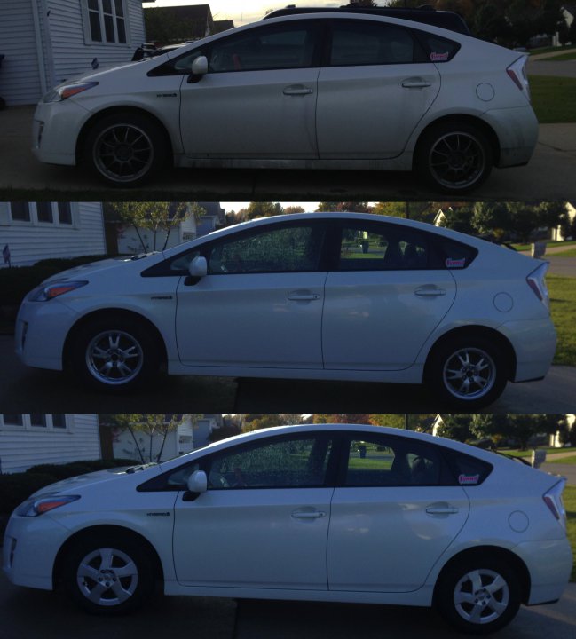

    I decided to go with Continental True Contact (standard touring a/s). So far my mpg is around 52mpg rather than 60mpg compared with the Bridgestone Ecopias I had on my 17" wheels. Overall, the Continentals perform well in dry pavement, quieter than my Ecopias (56,000miles on these tires), and I'm sure they will perform well in the snow since they have a similar design to the Pure Contacts. I highly recommend getting these, especially when they're $75 on tirerack.com and comes with 90,000 miles warranty.

    Update on my continental tires. I have 2,000 miles on my tires right now. Feeling bittersweet right now, since I was rear ended :/ but these tires are phenomenal. I like these more than my Bridgestone Ecopia EP422 A/S. I had great stopping power and took off with a breeze although handling is a little different (maybe it's because I'm use to driving with 17" wheels rather than 15"?) Driving on dry payment I rate a 9/10, rain 8.5/10, snow 9/10, and I did drive it on ice and my car was sliding but it wasn't as bad as other peoples. I saw a Impala spin out in front of me while I was going downhill and luckily the traction on my tires were good enough for me to avoid it. :) By the way, my average mpg with 30 degree weather is about 45-48mpg (I warm up my Prius 10-15 minutes before I drive so yeah...)
