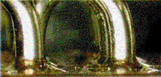

    Last year, I learned about the NASA tin whisker investigators at Goddard Space Flight Center:
    In fact, they had looked at a Camry accelerator with similar problems to the NHW11. Of the lessons learned:
    • modern VOMs may or may not detect tin whiskers
    • older VOMs can 'burn out' the whiskers when trying to measure the resistance
    • tin whiskers can form a thin oxide layer and have semi-conductor, variable resistance
    • less than one volt can 'burn out' existing tin-whiskers
    So as an experiment, I used a 'wall wart' power supply and jumpers on known, bad accelerators. First I confirmed they had the problem; then applied the 12V 'wall wart' power to the different encoder pins and cycled the accelerator. When I then went back to check, the resistances were solid and did not wander. In effect, the 'wall wart' burned out the tin whiskers.

    Conversations with the GSFC team suggests 'tin whisker' growth is not predictable. Some metals are more prone to growth (tin and zinc) yet when and how whiskers form remains an area of active investigation. The whiskers look like 'metal crystals' but no one knows, yet, what causes the nucleus to form or how adjacent atoms get sucked from the metal matrix and added to the base of the whisker.
