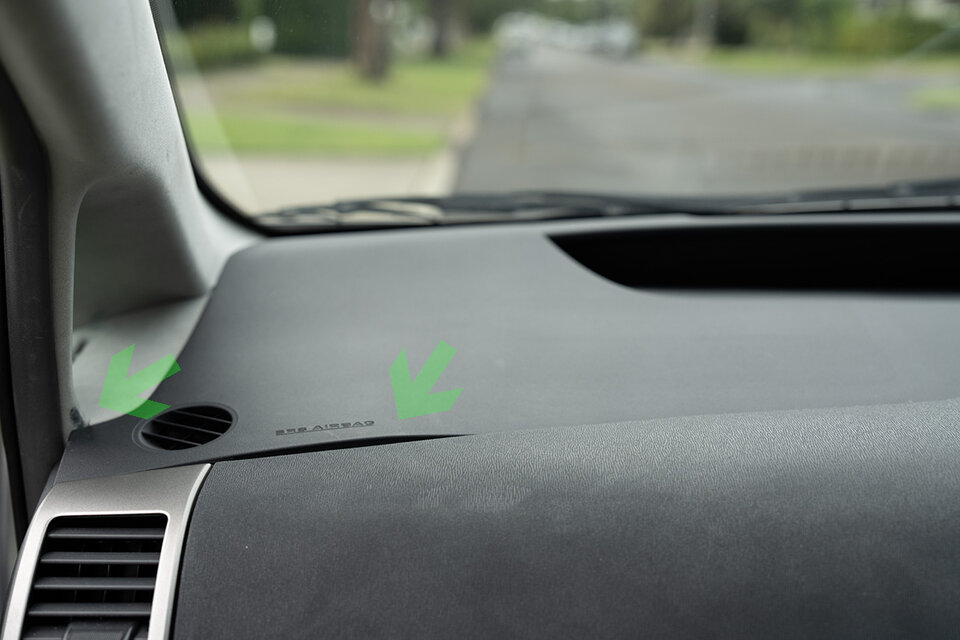

    Car went in for body work, they swapped 2 passenger doors, I think in the process they had to remove the dash because a small section is popping up, guess they broke the clip(s) holding it down.

    THe bump in dash is behind upper glove box??? Pretty normal they're.

    Attached a photo to show it, they also nicked the finish on the pillar.

    That's funny in the United States eight out of every 10 Prius have that same hump right there it's in the plastic I have a couple of them off and haven't tried to fix them with the heat gun or anything like that I usually just pull another one that's not bent and drop it on the car put the screws in the clips on events back in and there it sits forever if I fix the CM monitor it's never coming off again probably do everything in there while the dash top is off speaker off the back of the board etc so I'm not going in there again I hope

    Interesting, now that you have said it, I went on to an used car portal to take a look, some of them have that same bump as well.
    https://www.carsales.com.au/cars/toyota/prius/nhw20r-series/
    Guess could be an indicator if the dash was ever removed, difficult to put it back properly (can be done but typical installers may not have the specific knowledge for this car).

    I'm not sure how it happens I have them and I have them without it taking the dash off does not seem to be the problem I think what happens is when the upper glove box gets weird the hinges mess up when the glove box opens it rubs right on that spot in some cars may be more than others but taking the dash off doesn't do squat to that spot I literally pull the dashes off all the time in about 20 minutes breaking the vents while I do so because I have replacements to install because it doesn't matter I literally rip them out and throw them on the floor take the black pieces out of the vents put them in the new silver pieces that I have sitting in a box they don't go back in the car until I'm completely done working on the dash under the dash in the dash behind the dash those vents and things are not going to go back in until everything is completed everything that takes a week there's No vents in the car for a week the black pieces are just shoved into the vent ducks themselves and I ride like that until I'm finished with all the nonsense then the breaking parts can go back in never to be removed again during my stewardship hopefully so I make sure it's done you don't want to put all this back together and find you have something stupid going on to just rip it all apart again at least I don't but I don't think that comes from removal of the dash the ones I see this in our cars that look like they've never had a part taken out of them in their lives most of these cars I received generally haven't had the dash pad out it doesn't look like and all the parts that require the dash pad to come out have generally never been touched because I'm touching them
