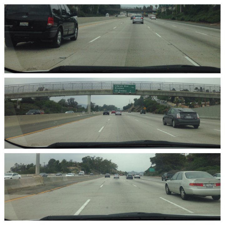

  17. BrianPB
    BrianPB Member
    Mar 14, 2013
    114
    36
    Sylmar, CA
    The three photos are at 70 mph, going from shortest setting to longest setting top to bottom
    wcg66 and Mendel Leisk like this.
