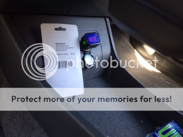

    Here was round two:

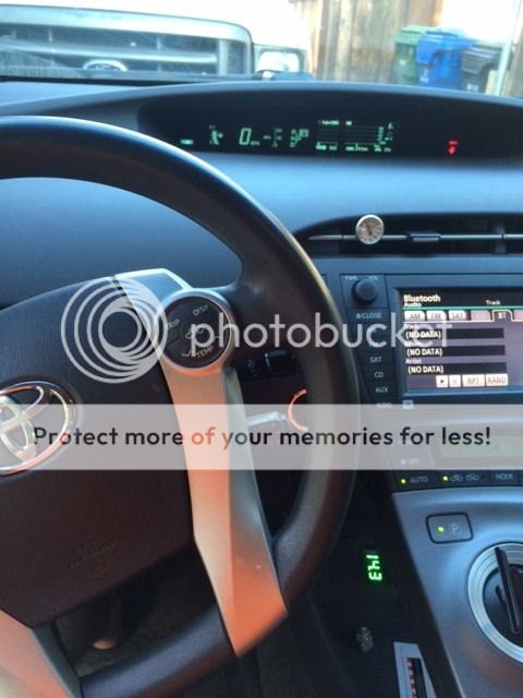

    That worked, the color of the digits at least wasn't red, and it allowed me to plug in the charger. One problem. From the driving position, you can't see the readout for either this solution or the first solution unless you hunch down to look under the bridge:

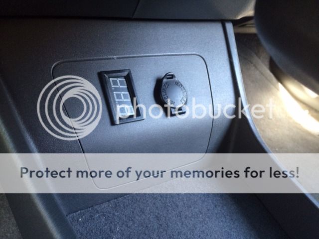

    Here's the final solution:

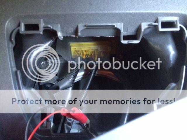

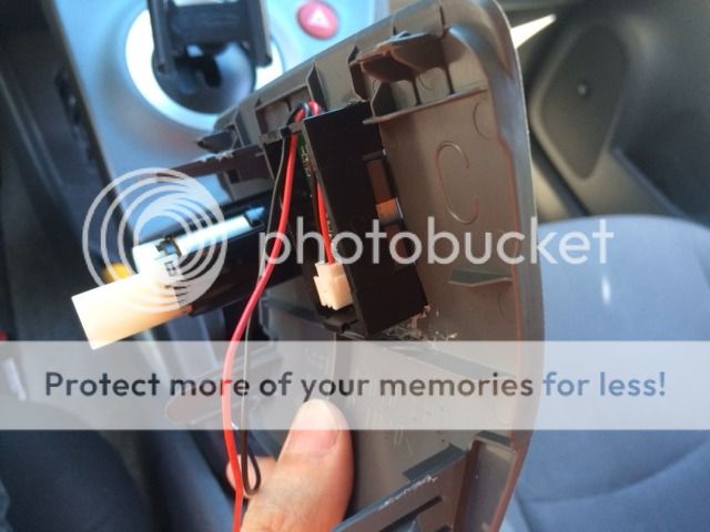

    Voltage display from adafruit placed where the blank was in my car. I had to enlarge the hole to the top and the right slightly to make it fit. I had to remove one of six tangs to make room. This small trim panel would do fine with four. Five is plenty:
    Once the hole is the right size it snaps in position with the side tangs on it's case:
    I also removed the female portion that the tang went in to give room for the bulk of the device when the panel is back in place:
    I used positaps to tap into the ground and +12V leads that go to the 12V outlet. (The car harness had the black wire as +12V and the ground is the striped wire):
    Here it is installed:

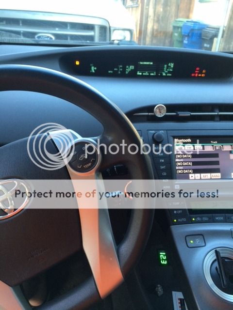

    Here it is from driving position:
    It's pretty close to the dash color, is easy to read, and cheap at less than $8.

  2. xliderider
    7,869
    3,116
    Does it read 13.x volts when the Prius is in Ready mode?

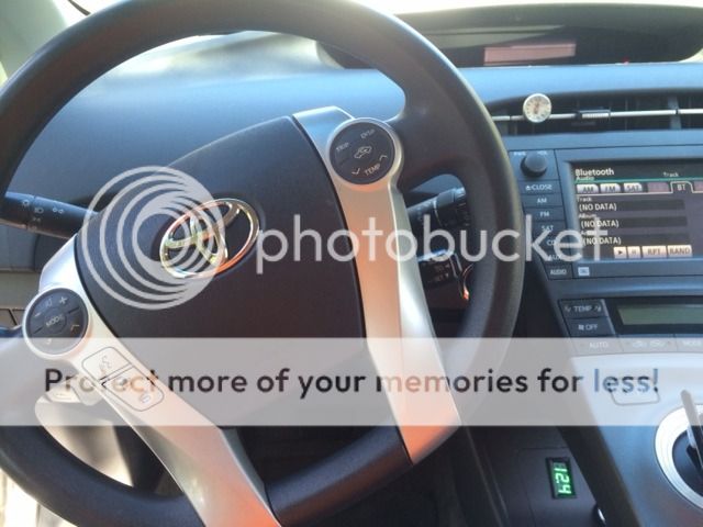

  4. thordehr
    thordehr Member
    Aug 4, 2013
    71
    47

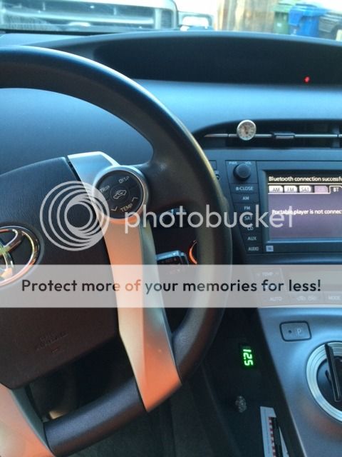

    One start push, no brake pedal to get the first stage accessories going (radio only):
    Second push, no brake pedal, to get all accessories going along with dash:
    Car in full ready mode:

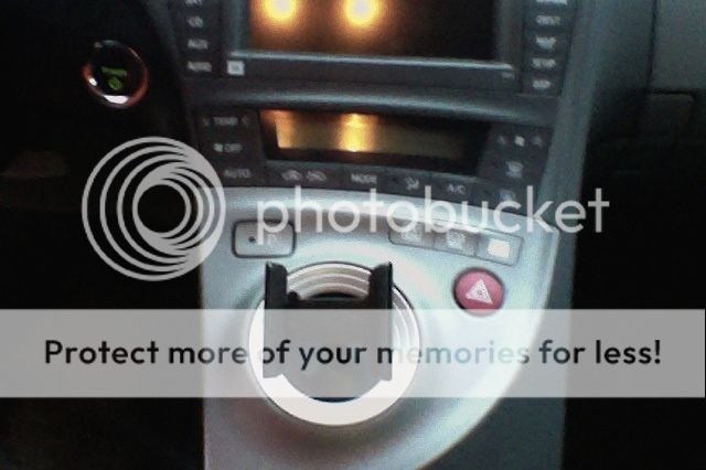

  9. thordehr
    thordehr Member
    Aug 4, 2013
    71
    47

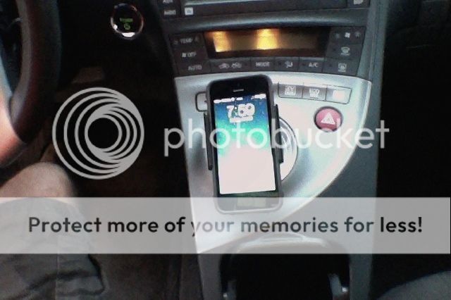

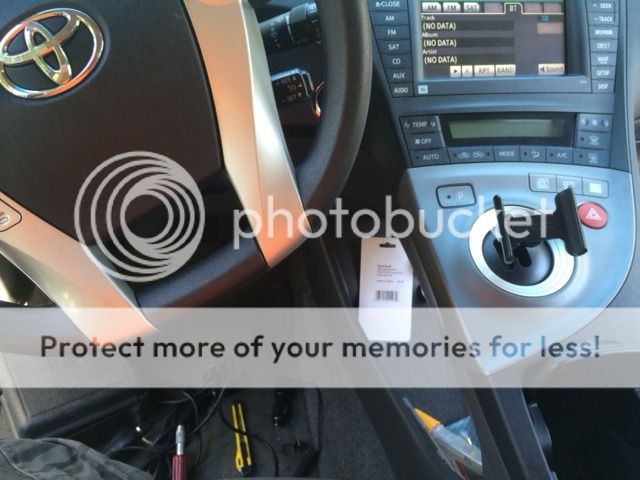

    Wish I could take credit for it, but it was another user here on PriusChat. Shift knob replaced with piece of this device:
    In Your Face: Welcome - the best smartphone holders
    I use it every day as soon as I get in the car.

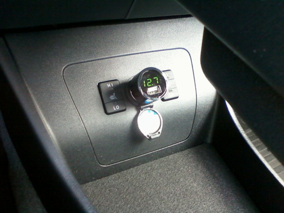

    2014 Prius Plug-in

  16. se-riously
    se-riously Active Member
    Nov 25, 2010
    263
    114
    SF Bay Area
    2014 Prius Plug-in
    Well I did write "compromise". That said, on the PIP you wouldn't have to hunch down much at all because the 12v outlet is actually located dead center between 2 heated seat switches. On your Prius, the 12v outlet is offset to the right, which requires you to hunch down more.
    Another option would be a 12v splitter, which would move the display more to the left.
