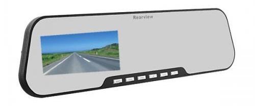

    I'm adding a mirror dash camera similar to the one pictured below. My question is where would you get the 12 volt switched power? I'd like it to operate when I start the car until I turn the vehicle off. Due to those side curtain airbags, I'd prefer to not have to run a long wire to the 12 v outlet under the console. I'm thinking about the dome light area. My 2011 Prius does not have a sunroof.

    I don't think the dome light is switched. I wouldn't worry about the side curtain bags. Just zip tie the wire to the existing wire that is running along the pillar. I ran mine down the passenger side. I bought a new cord that has a USB end on it. It plugs into a 4-way USB port in my glove box which plugs into the 12V outlet. The 4-way USB also powers a router I use to stream videos to my kids tablets. Eventually I'll hard wire the 4-way into the 12V outlet.
    If you haven't already ordered, you may want to consider a different dashcam. I don't think the one you are looking at is rated very well. I have the G1W-C that I bought from SpyTech and have been very happy with it: Complete Review of G1W-C CAPACITOR based dash camera NT96650 + AR0330 1080p / 30Fps | DashCamTalk

    Yes, I ordered it off eBay. It was very inexpensive which is why I went for it. I want it to be a mirror cam because I don't want to have to remove it when I get out of the car. I was thinking about that little light that aims at the shifter from the overhead console. It is switched and on the headlights control.

    I guess you could run it off the light. You would just need to make sure your headlights are always on. Note that there is a good possibility that the camer is 5V. If it is like mine, the voltage converter is in the plug so you can't just cut and splice. There are voltage converters available. To me the easiest way was to purchase a new cord that plugs into a USB adapter (USB runs 5V).

    make the harness and have it come down to the fuse boix then tap the fusebox

    I just order one also for 38 dollars and ya i double check it to make sure it is the latest chipset. But ya i will be tapping mine to the fuse box with the 5v to 12v harness that they sell on ebay
