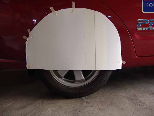

    People have made rear wheel skirts for the prius but so far they are either butt ugly or they added a whole side panel to keep everything in line. The question is can the prius have after market rear wheel skirts that look almost stock with minimal material? I say yes it can!

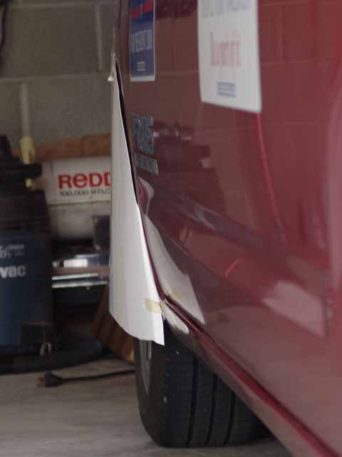

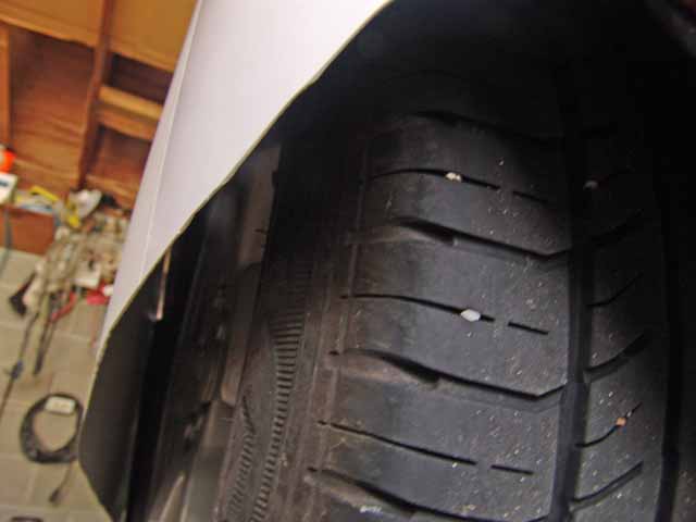

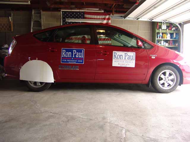

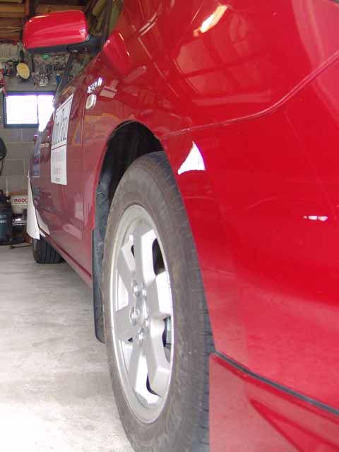

    I have no idea on how how to make any custom body part for a car but I'm giving it a shot. I bought some poster board the other day to make a template. I have cut it to roughly to the right size. I fitted it on my Prius with some masking tape. Bent it out a little and I have found that a wheel skirt could possibly be made. The clearance between the template and the tire is more than an inch and can be made wider with out making it look to ugly. The result is that the skirt does not stick out very far and if made into a finished product it could look stock.

    Side view of the template.
    Close up of the side view.
    What is looks like from the front of the car.
    Closer view from the front.
    Clearance from the tire.
