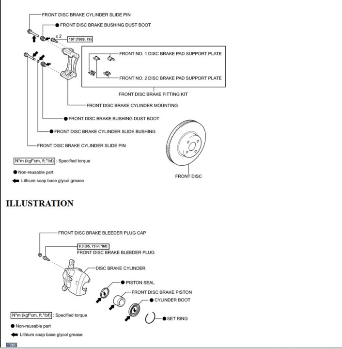

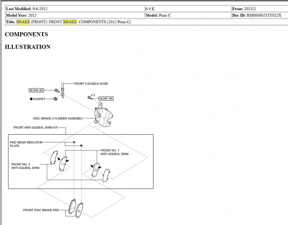

    That's all wonderful, but what does any of it have to do with brake service being any different than a non hybrid ????
    Before, you were making statement alluding to the hydraulic system "going off" ???
    The brakes pads, calipers and rotors aren't any different than a standard car. The regeneration
    happens inside the CVT. The system activates and slows the vehicle, but it's not controlled by the calipers, pads or rotors.
    The brakes on a Prius are the exact same design as any non hybrid. There's nothing different
    when performing pad, rotor or caliper replacement. It has ABS, but all new cars do. It's not gonna active the hydraulic system when you remove the caliper. To much urban myth crap floating around as truth. It's STANDARD brake design and it's serviced as such.

    Here's the front brakes on a 2012 Prius C.
    As you can see, it's nothing more than front disc brakes with ABS :eek:
