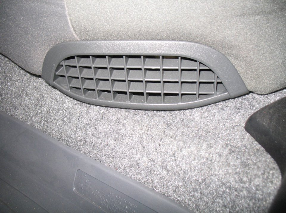

    Photo added of left rear seat vent by floor.
    AZPriusdriver and 32kcolors like this.
