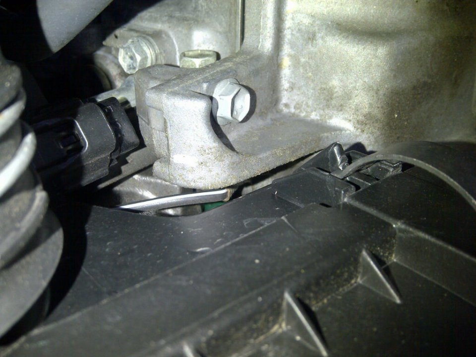

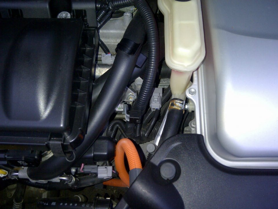

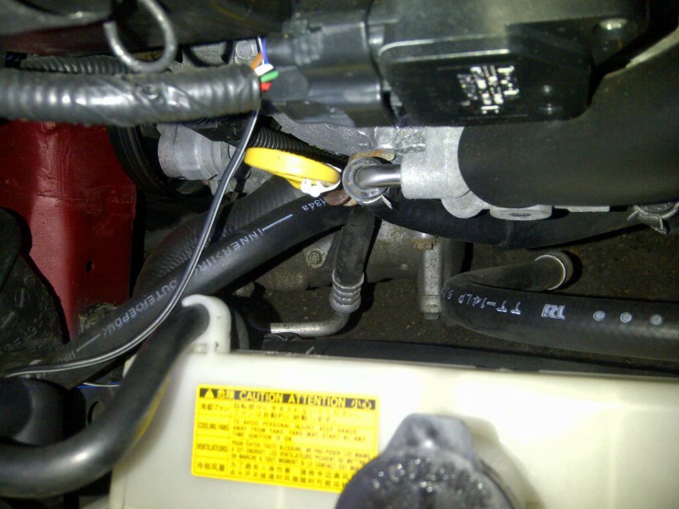

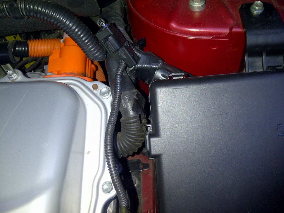

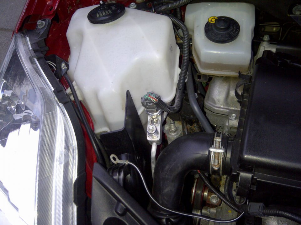

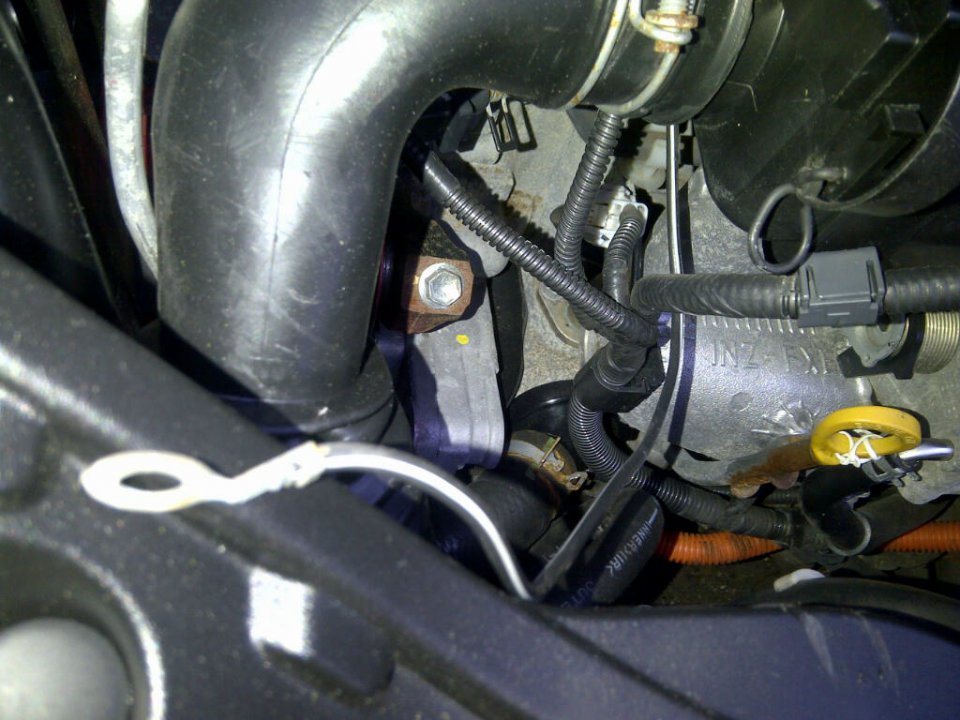

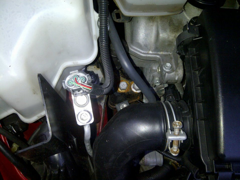

    I just found abit of time this evening to carry out your checks, and whilst I was getting the car ready for them - I noticed that a cable was loose, and so I thought that I should ask you about this before I turned the car on.
    I tested the car alarm earlier but I don't think this is related to it.
    There's a cable - looks like an earthing cable which I found wasn't attached to anything - had a loop on the end of it. Whilst I had the bonnet open - I took more photos of the car for you to see if everything else looks okay. There's alot of black tape everywhere but unsure if this is normal.
    I'm attaching all of the pictures I took, including the cable and where it was coming from.
    your thoughts, as always are welcome
    thanks again
  8. Britprius
    Britprius Senior Member
    Jun 14, 2010
    5,194
    1,914
    Herefordshire England
    Yes I agree that looks like a Chassis grounding cable (earth) I will check on my car to see if I can find where it comes from and goes to. I am going to the Midlands tomorrow to see if I can organize some parts. Check on those rad fans they are important.

    P.S. images 1 and 2 show the end of the cable and also where it comes from. It looked like it came direct from the engine. Unsure if the image highlights this well enough.

    RE: the earthing cable - I spotted a local cab driver who had the same Prius as mine and so I approached him to see if I could look at where that cable is connected. It looked as though it went straight to a nut under the black plastic rim/covering towards the front grill of the car, under the bonnet, on the driver's side. So I got home, pulled that section up, spotted a small size 10 nut, un-did it and connected the earthing cable underneath that. I think this sorted it.
