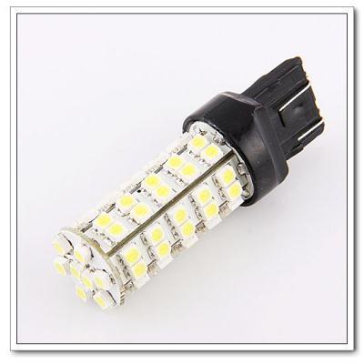

    Four 7440 amber 68 LEDs for the turn signals.
    Two 7440 white 68 LEDs for the reverse light.

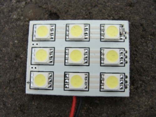

    Nine of these. This came with a T10 adapter and a spring loaded adjustable thing for the other lights like the cargo and door lights.

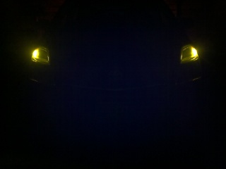

    Parking lights.

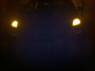

    Turn signals.

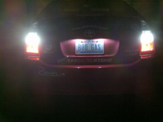

    Rear tail, license, and reverse lights. Had to take this one quick before I was ran over. :D

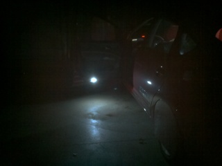

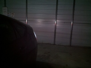

    Reverse lights showing how much they light up. To me they do just as good as the regular bulbs.

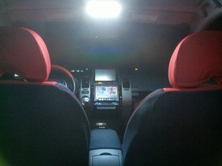

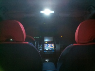

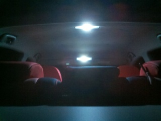

    The 9 LEDs for the front and rear fade in and out just like the regular bulbs.
    The single light.
    All 3 turned on.

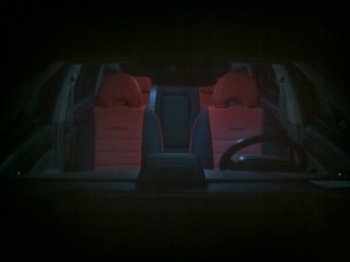

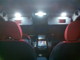

    The sun visor lights.

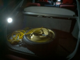

    Cargo light. Had to bend the cargo light light holder a bit to fit the adapter.
    And the door light.

    How do the turn signals show up in bright, direct sunlight? I wouldn't mind going to LED turn lamps since I use the front turn signals as DRLs, but most of the conversions I have seen don't look bright enough to be safe.
  6. TheForce
    TheForce Ron Paul 2012
    May 30, 2005
    3,454
    469
    Wheelersburg, Ohio
    The turn signal LEDs are bright enough in the sun for turn signals but not for DRLs.
