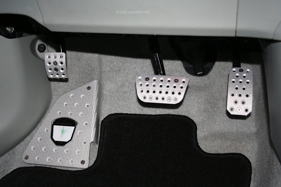

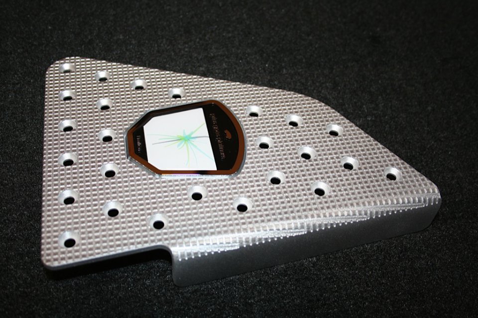

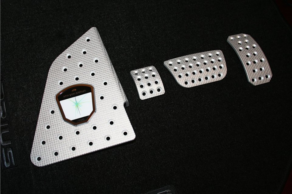

    I’ve installed a set of custom-made aluminum pedals from Ultimate Pedals. Unlike pre-manufactured pedal sets that many here have, everything through Ultimate Pedals is custom-made to your exact specifications with options like mix-and-matching surface finishes, adding a flange/extension, custom engraving, object pocketing, etc. My primary motivation for going through them is I wanted a flanged dead pedal/footrest cover, which isn’t available with pre-manufactured sets. There’s a strip of carpet to the right of the dead pedal that is extremely susceptible to wear (which is a stupid design on Toyota’s part) and the flanged design means the metal runs over to the side, which would completely prevent carpet wear.

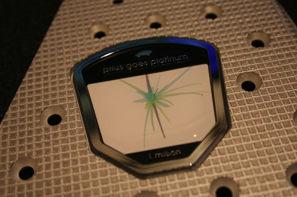

    After working closely with Rob Baylor of Ultimate Pedals and no fewer than 20 back-and-forth email correspondences to check paper templates, etc., I had them do custom-pocketing of my “Prius Goes Platinum” badge, a one-of-a-kind badge celebrating one million Prius sold of which only 1000 unique examples were produced that turned out to be very nice medallions, in the footrest cover (to break up the large area that it occupies). For surface finish, I selected frosted (satin) as it’s a better match to the finish on the steering wheel trim and door pulls than shiny (brushed). I also went with anti-slip without grip inserts for all the pedals. They manufactured the pedals in just three days after receiving the badge and my final confirmation (I changed my mind on surface finishes a couple of times after ordering).

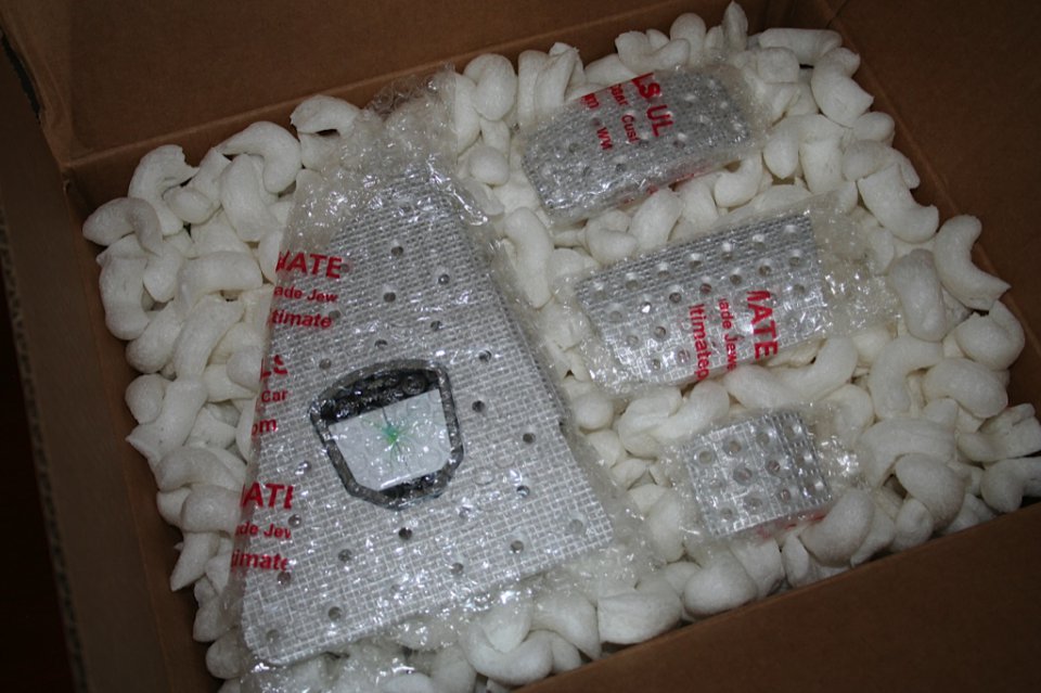

    They weren’t kidding when they bubble wrapped the pedals with a packaging tape that reads, in part, “Custom made Jewelry for your Car.”
    The anti-slip surface is quite grippy making rubber nubs unnecessary, although you still have the option to add grip inserts if desired. Rob Baylor designed the parking brake pedal to be larger with 12 countersunk holes, as only four holes of which two are occupied by screws (if it were to be the same size as stock rubber cover) would look silly.

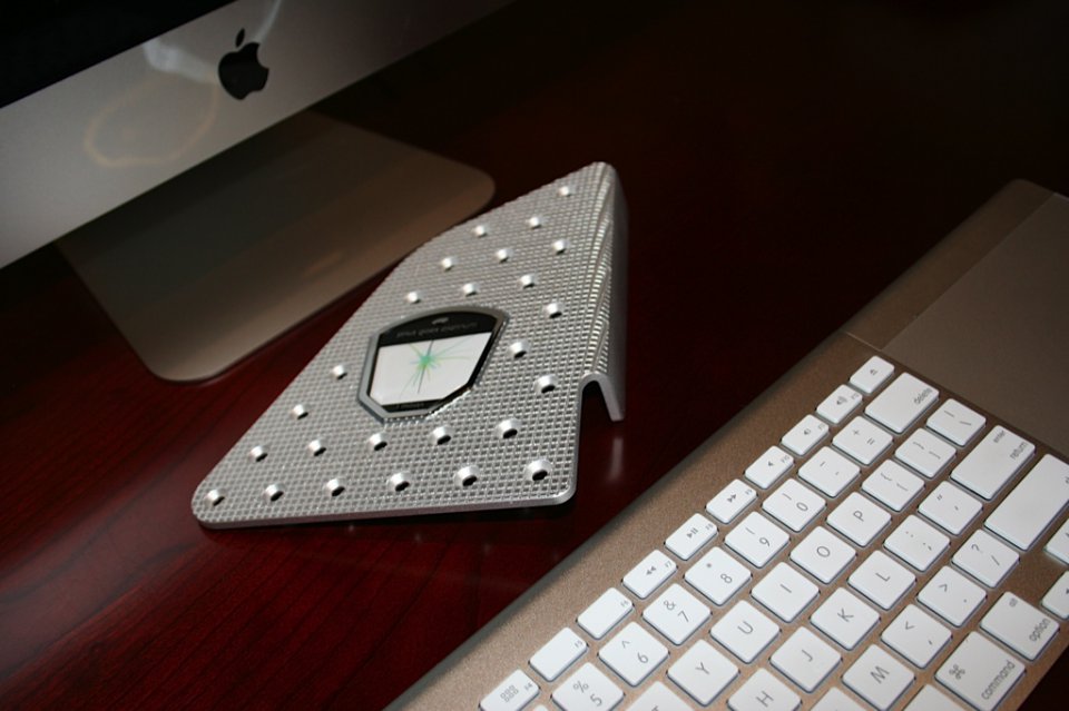

    The pedal feels right at home with the aluminum iMac, keyboard and trackpad :)
    The frosted finish (obtained by blasting with glass beads) goes well with the silver interior trim. It’s also their most popular finish.

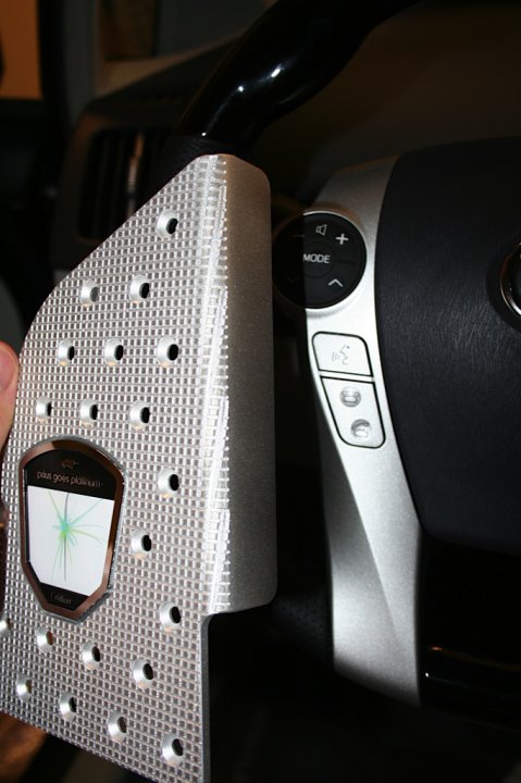

    The “Prius Goes Platinum” badge pocketed into the footrest cover. In hindsight, I should have fudged the mileage to get prettier graphics on the badge :D
    The recess is deep enough so that the badge sits flush with the surface. The anti-slip finish, while not necessary for the footrest, provides a good contrast to the badge making it pop. They’ll allow you to mix and match surface finishes (e.g., smooth for gas and dead pedals, anti-slip for brake pedal, etc.)

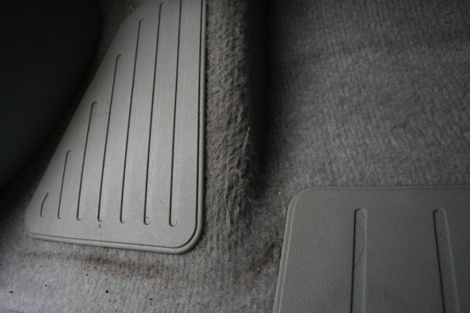

    Check out this sorry state of the footrest area with excessive carpet wear. I started noticing carpet wear after about 10K miles and trained myself not to touch the footrest area/use the dead pedal thereafter (until now) but the damage had already been done.

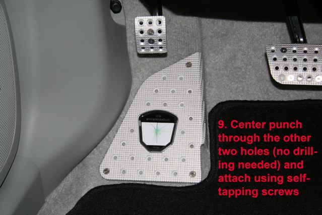

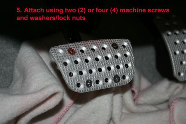

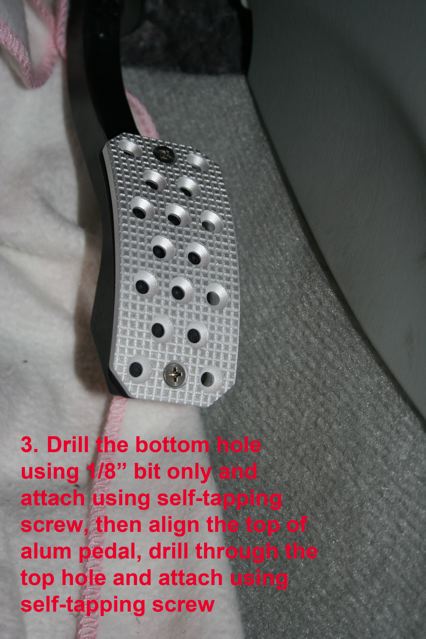

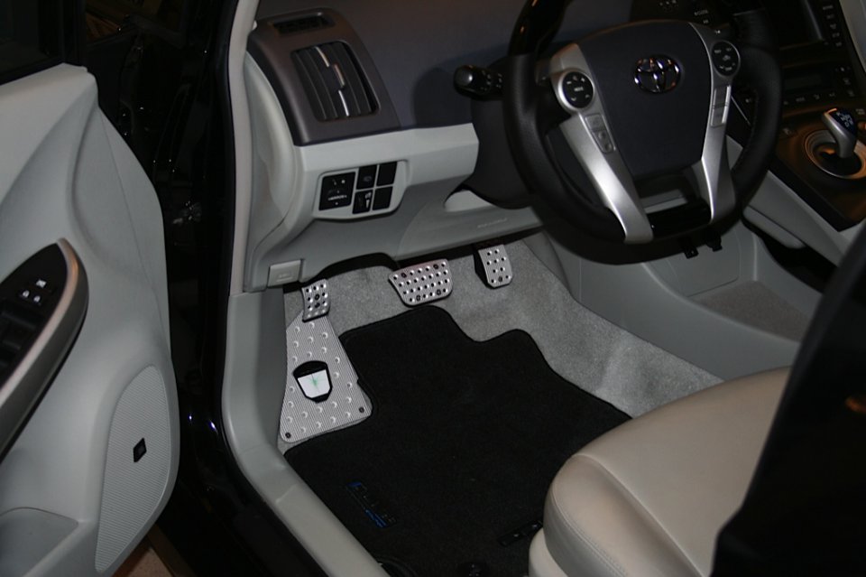

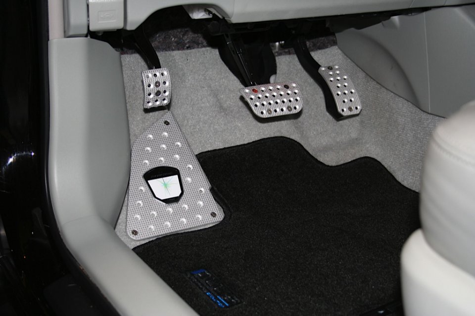

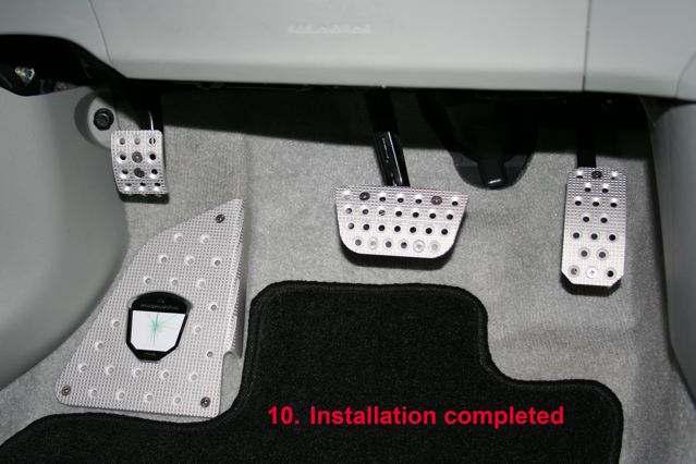

    After thoroughly dry shampooing the area, the pedals were ready to be installed using the supplied screws (self-tapping screws in the plastic throttle pedal and footrest area; machine screws with washers and lock nuts in the brake and parking brake pedal sheet metals).

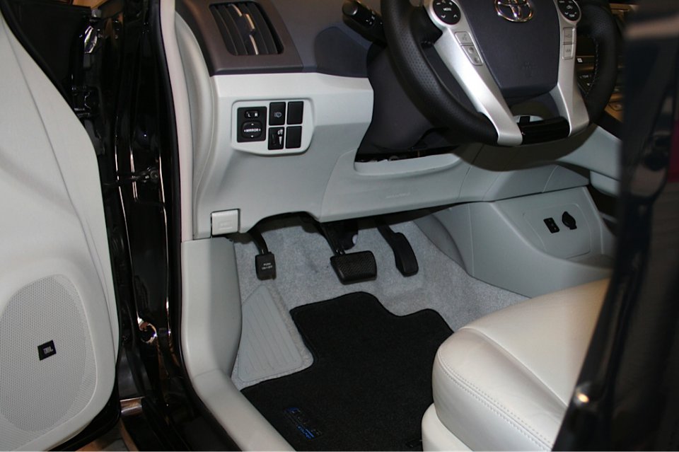

    Installed
    [​IMG][​IMG]
    Stock Pedals
    Ultimate Pedals
    In all, I absolutely love how they turned out and I am immensely impressed with Ultimate Pedals' craftsmanship.

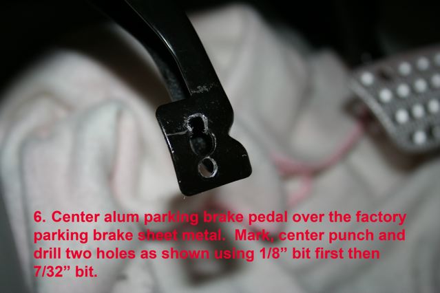

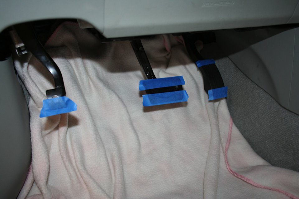

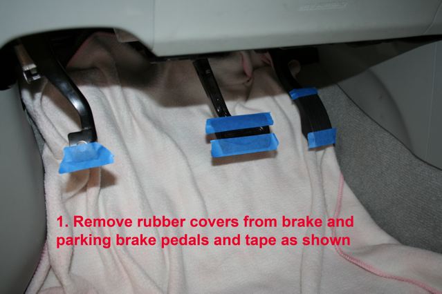

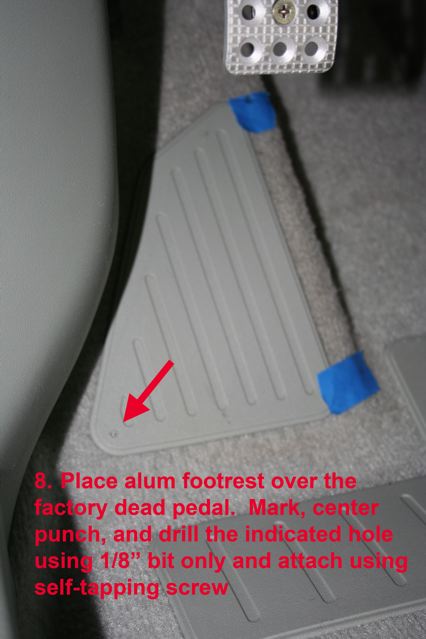

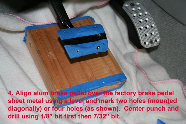

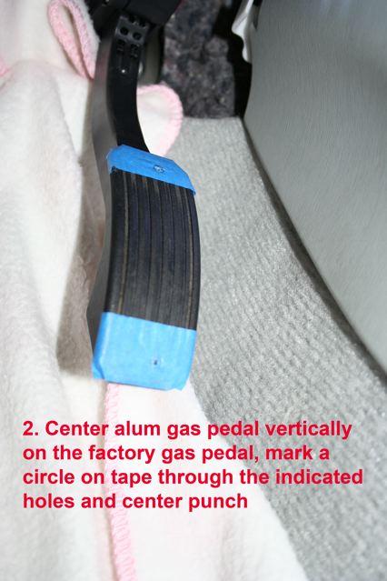

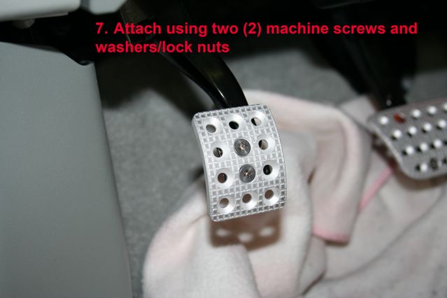

    I believe all mods on priuschat should be accompanied with step-by-step instructions and this is no exception, so here goes.
    Tools needed:
    • Philips screwdriver (preferably a stubby one)
    • 8mm open end wrench (or better, 8mm socket with thumb wheel ratchet)
    • 1/8” and 7/32” drill bits (preferably stronger titanium or cobalt-coated for drilling through metal)
    • Small electric drill (I borrowed my father’s 30-year-old corded drill rather than use my oversized cordless one)
    • Automatic center punch (a great tool for “etching” a starter hole)
    • Pencil
    • Masking or painter’s tape
    • Level
    • Small mirror (borrow from your kid or wife)
    • Block of wood
    • Towel or blanket (to catch the many shards of metal that will fall to the ground)
    Item not needed:
    • Degreasing spray
    Tips:
    - Keep the drill bit moving before you hit the etched starter hole. This makes it less likely for it to walk away out of position on metal. It also helps to use the center punch 3 or 4 times to etch deeper dimples.
    - Align the left edge of the alum gas pedal so that it is nearly flush with the left edge of the factory gas pedal and do likewise with the right edge of the alum brake pedal to be flush with the right edge of the factory brake pedal sheet metal. This will provide maximum clearance between the two pedals.
    - I didn’t realize until after I drilled the four holes in the brake pedal sheet metal that it actually hangs crooked relative to the floor. This is where the level comes in handy. I had to re-drill three of the holes slightly shifted to position the alum brake pedal so it sits more evenly (easily done as it’s a bit larger than the sheet metal).
    - The small mirror and thumb wheel ratchet are helpful for tightening the lock nuts in the limited space under the metal pedals. You just hold the Philips screwdriver in place and turn the thumb wheel.
