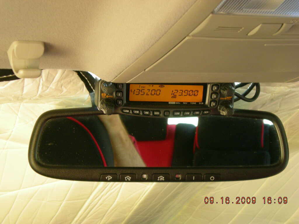

    John, Hi there! Yeah, I have plenty of thoughts on mobile radio installs!
    Measuring just 6.1” x 2” x 9.2” (155 x 52 x 233 mm), the FT-857 is the world’s smallest full-power HF/VHF/UHF multitmode transceiver!
    Good choice!
    However before you go through all the effort of the install, I would jury rig power from the 12 v battery to the 857, get the antenna on the car, without making any holes yet. Last step is turn on the ACC PWR and fire up the rig. Get an idea on your locations noise floor, find somebody weak, and then turn the car full on! What happens? Some reports state the nose floor will jump to S9 or more. That kind of renders the HF thing moot.
    On the other hand there have been several great write ups, one by a ham, who shielded the bejezus out of the car and had significant success on dropping the noise floor down to usable HF op levels! If you find after the test, you can live with what you hear, or you plan to shield the bejezus out of your car go for it! The display for the 857, due to its size 6.1" x 2" you could mound above or below your mirror like I did using a "Blend Mount" I run a FT-8700!
    As for the rig body, hide it in the back of the car, I buried mine in the Gen II's left rear pocket in the back. Fits perfect. I actually ran my coax through the hatch's wiring channel, going through the water proof boot. I use a Diamond K-400 mount, what you have will work. The setup is neat!
    Good luck, let us know how you make out!
