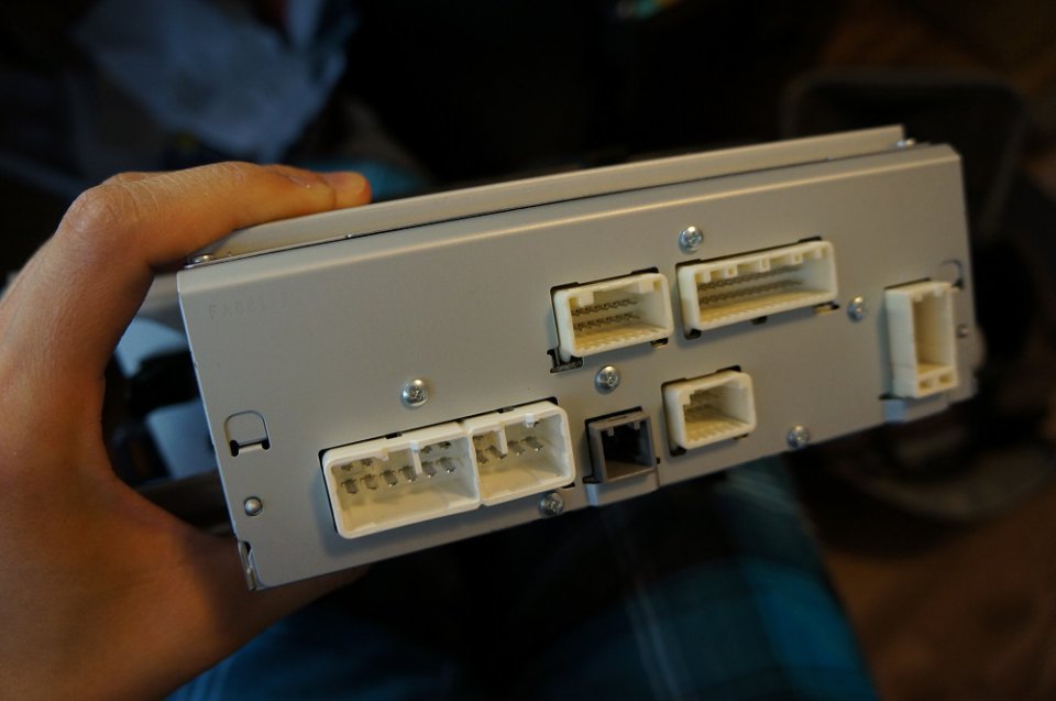

    Hi Quinton,
    I've replaced my entire audio system and still have the old parts. The factory deck connections at the rear look like this:
    There are no pre-amp outputs...even the antenna connection for AM/FM does not use the standard plug!
    Hope this helps!
    nugimon likes this.

    How did you hook up your subs and amp without any of the pre amp outputs in the back? And that's the 2011 prius three jbl no nav radio?
