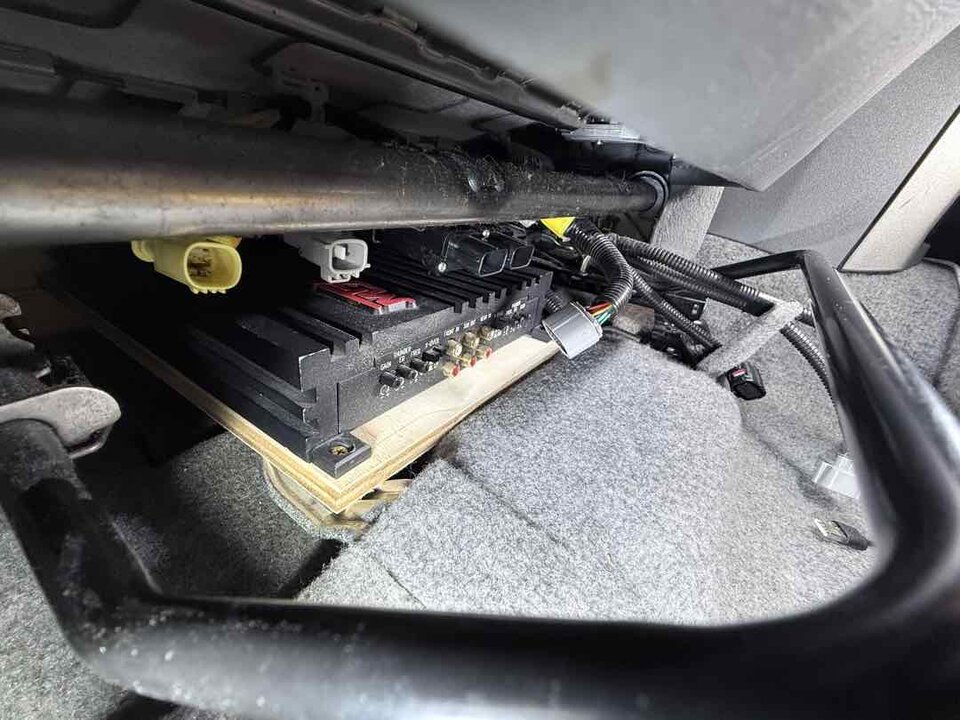

    I’m replacing the JBL Amp with a larger class A/B amp under the passenger seat (an old MTX Thunder 4x40) to power all door speakers.
    I might do a full re-wire. Never added an amp to a car with a large battery bank before. Any spots I should avoid that cause a lot of signal interference?
    Amp 1
    - power will run from rear battery along pax side to amp, grounded just under the pax seat.
    - RCAs directly from head unit to amp, about a 2-3 foot run.
    - all speaker wiring will run up or down the center hump first, then split left or right to the front and rear doors.
    Amp 2 (future small woofer)
    - under drivers seat.
    - power will follow amp 1, coming from pax side, under front of rear seats to avoid speaker wiring as much as possible.
    - small subwoofer wiring will travel down driver’s side past the main battery’s connector.
    Any feedback appreciated, even if you ran it a different way, I can know what does work.
    Thanks!
  2. Priapet
    Priapet New Member
    Sep 23, 2025
    In my Prius
    Also, I set up my amp mount with a panel in the back. I like how it’s hidden, but it might block ventilation for people in the back. I don’t normally have any passengers. Any feedback if I’m forgetting something appreciated. :)
