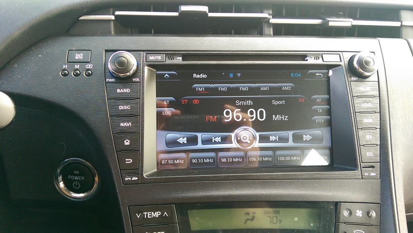

    Guys, few questions for Android's installers
    - what is HU's boot time. Does it wakeup from screen off state or cold boot?
    - what about RDS FM tuner functionality? I know Chinese are not the best for the full functional RDS.
    - if Torque app installed and started, are other playback functions, e.g. FM tuner, MP3 DVD...., available?
  12. neez
    neez Member
    Jan 9, 2014
    194
    37
    I have the dual core 1.6ghz model, bootup time is fairly long, but not too long. It's usually fully booted from the time i start my car, to the time i leave the parking lot. Hasn't been an issue for me.
    It does have RDS, but doesn't show too much information due to not using enough characters to display the full text. It scrolls the information, but it takes forever. See the attached picture, i think that's sam smith on the radio.
