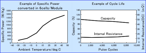

  17. bwilson4web
    Nov 25, 2005
    27,141
    15,399
    Huntsville AL
    Ahem, a lot less than 25A. Our NiMH batteries are rated at 6.5Ahr giving a 1C charge rate of 6.5A. But when testing batteries, it is common practice to use 0.1C.
    Don't get me wrong, any regeneration is better than none but less is best. If you can ballistic glide to a stop without be a safety hazard, that is best of all.
    Bob Wilson

    ken1784 SuperMID designer
    Dec 18, 2003
    2,940
    1,359
    67
    Yokohama, JAPAN
