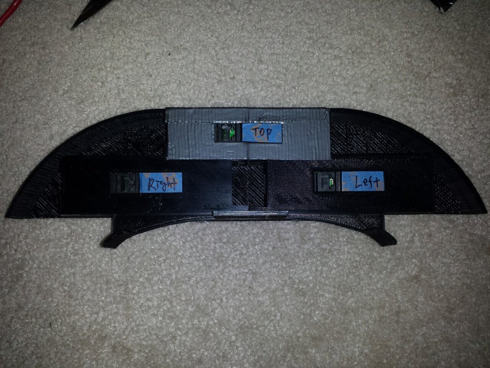

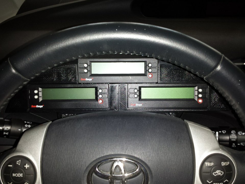

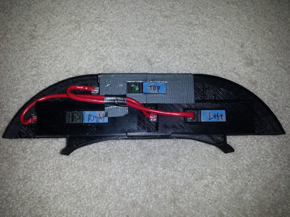

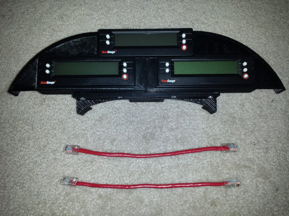

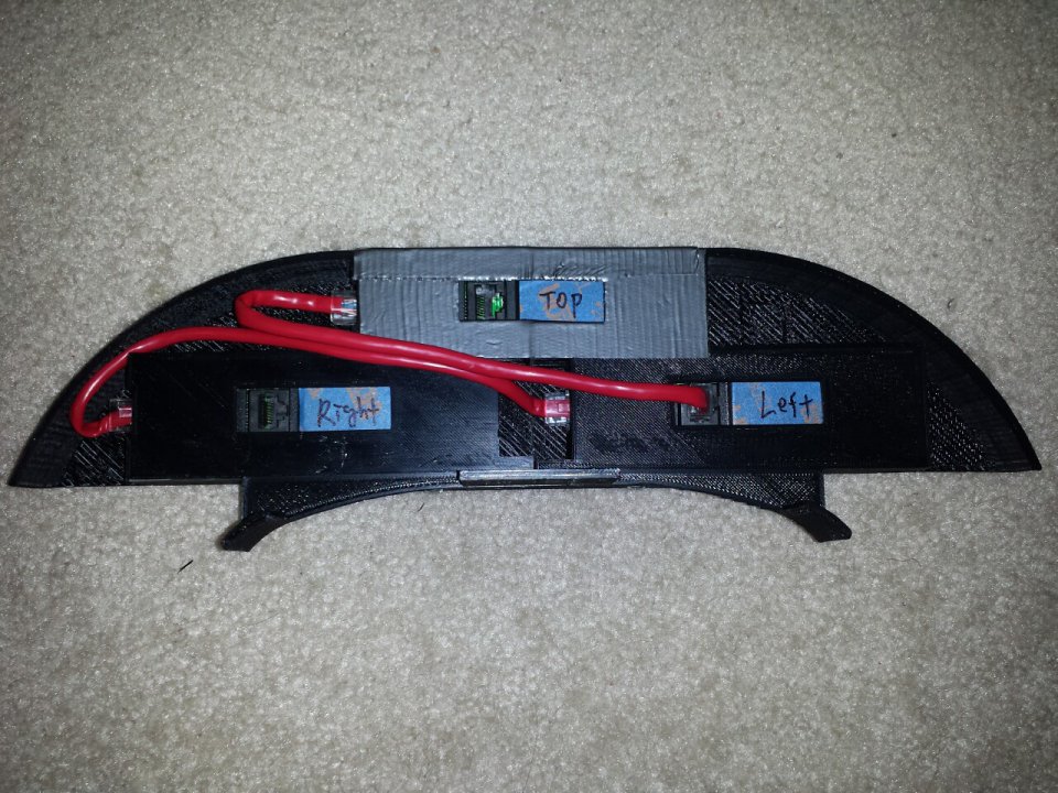

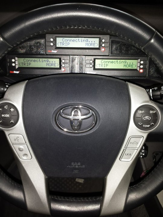

    I can't find any threads about daisy chaining, only that it's possible, so I'll start one. So I bought 3 over the years. Been using them in each of my cars. I decided to put all 3 of them in my Prius. I bought a daisy chain cable from Amazon to test out but it was too short for what I wanted. I commissioned my brother to make a couple of 8 inch straight CAT5 cables for me. The OBD-II cable plugs into the top Scangauge. From there, it daisy chains to the others. The top Scangauge has firmware 4.06 while the bottom 2 have 3.17. The backlight on the 4.06 and the 3.17 are different color even though they are supposedly the same color setting.

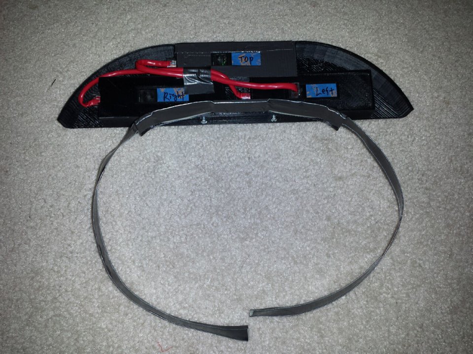

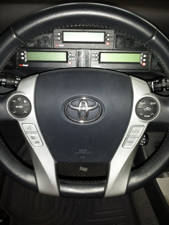

    I printed the Scangauge mount out of ABS. Since my printer wasn't big enough to print in 1 piece, I had to print 3 pieces and assemble them together with screws and tape. I use non residue duct tape to hold the 2 pieces together at the top and use screws for the bottom. The loop that goes around the steering column is also non residue duct tape. The duct tape is not visible from normal driving position. The Scangauge mount does not interfere with turn signal, high beam, or the wiper/washer. The steering wheel fully tilts up and down. The only thing that I loss is about 1/2" of telescoping steering wheel.

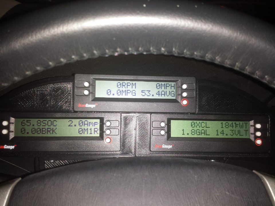

    Now I got 12 gauges going on.
    Top Scangauge
    RPM - I tried the X-Gauge RPM but it updates really fast for 1/2 seconds and stops for a second. I revert back to the regular RPM instead.
    MPH - Also tried X-Gauge MPH but it too updates really fast for 1/2 seconds and stops for a second. It does show 1/10MPH though. I revert back to regular MPH instead. I also Adjusted to reflect actual speed according to Police radar and GPS satellite speed.
    MPG - Adjusted to reflect actual mileage instead of the Toyota exaggerated mileage.
    AVG - Adjusted to reflect actual mileage instead of the Toyota exaggerated mileage.
    Left Scangauge
    SOC - State Of Charge
    Amp - HV Battery Amperage draw and charge
    BRK - Friction brake. Lets me know if friction brake has been activated.
    M1R - M/G 1 RPM. Sometimes I switch this out to reflect Motor 2 RPM. Found out that M/G 1 spins backwards sometimes.
    Right Scangauge
    XCL - Accelerator pedal position, shows 0-100. Shows 0 if I engage cruise control and releases accelerator pedal.
    fWT - Water coolant temp.
    GAL - Fuel tank in US gallon. Updates quickly, fluctuates as you accelerate, brake and turns. Low fuel flashes when fuel drops to around 1.5-1.7 gallons.
    VLT - 12V battery voltage. Sometimes I switch this out to reflect inverter coolant temperature.
    Overall, I like the extra info. However, I don't like that it's only in digital text format.
